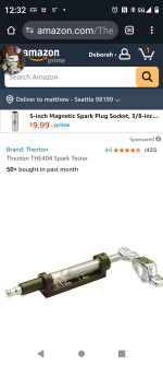

You need a spark jump tester....pick up one of these cheapies and look for a "zap" of 7/16, nice and blue.
As for the wife, we all have our secret ways! 🤣
