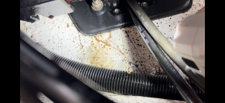

Thanks for the feedback guys. I’ve attached a photo of where the leak was coming from, it is a sort of brown stain on the left side. The mechanic is saying this is an indication of a wet transom. Today I went over there and did a very thorough sounding test on the entire transom, both inside and out. I did not hear any difference from the leaking area to other locations. It sounded bright and crisp with no hollow sounds at all. Shouldn’t I be able to hear the difference if it’s as bad as he’s telling me??

It could be just an assumption, so it needs to be verified before putting money and effort into it.
it might be good to get the boat out of the water and take some core samples of the transom, both near the leak and elsewhere

Your picture doesn't look too bad. Brown water can be rot...or rust.

Sounding test is worthless unless the boat is completely rotted away or you are highly experienced at examining boats. Drilling core samples from inside is a MUCH more reliable way to check for rot.

Probably a 1/4" drill from the inside near the leaking area and a few places higher. Go about 1" deep (the transom is 2" thick). Take pictures and save samples of the shavings, noting if the are wet, dark, mushy, etc.
