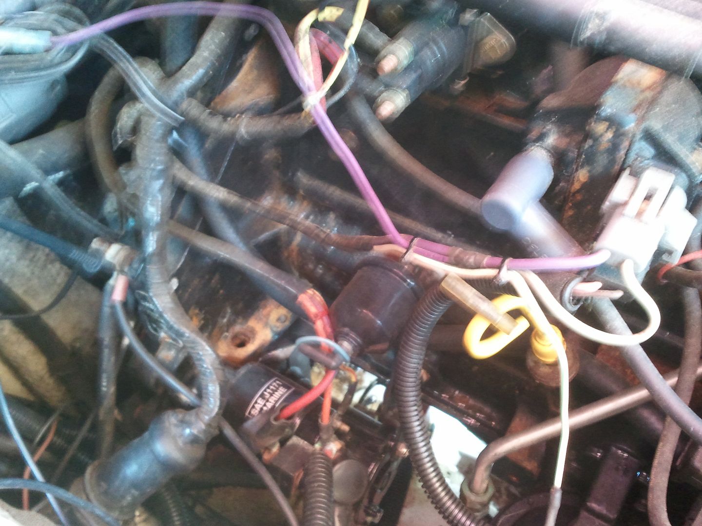

This is what im working with.
starter
other part
big picture

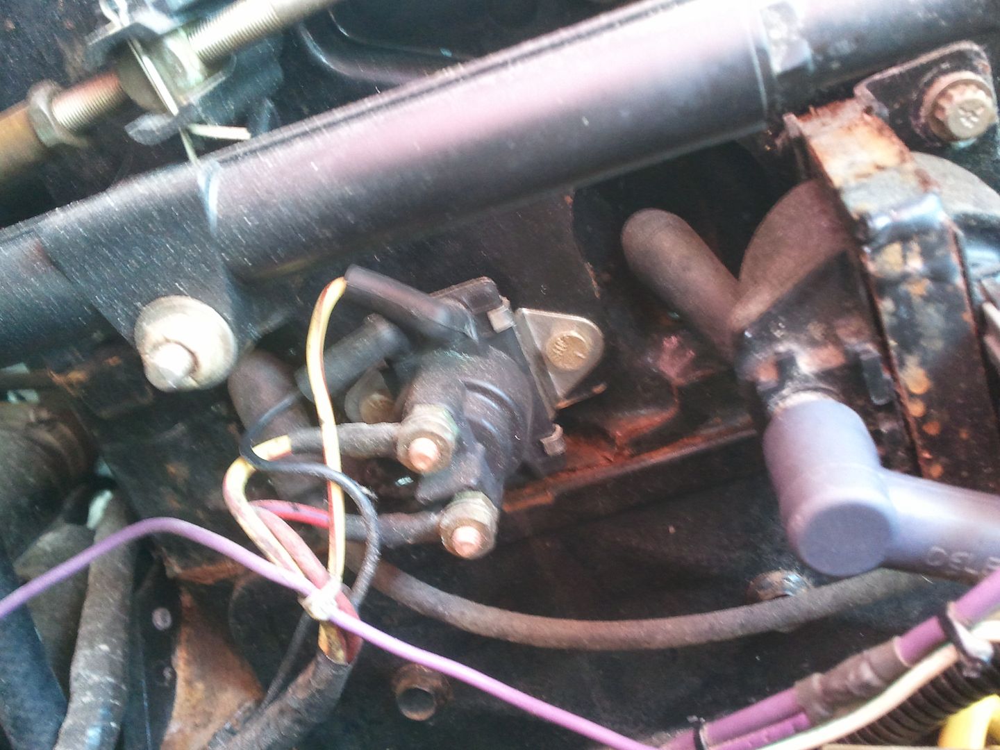

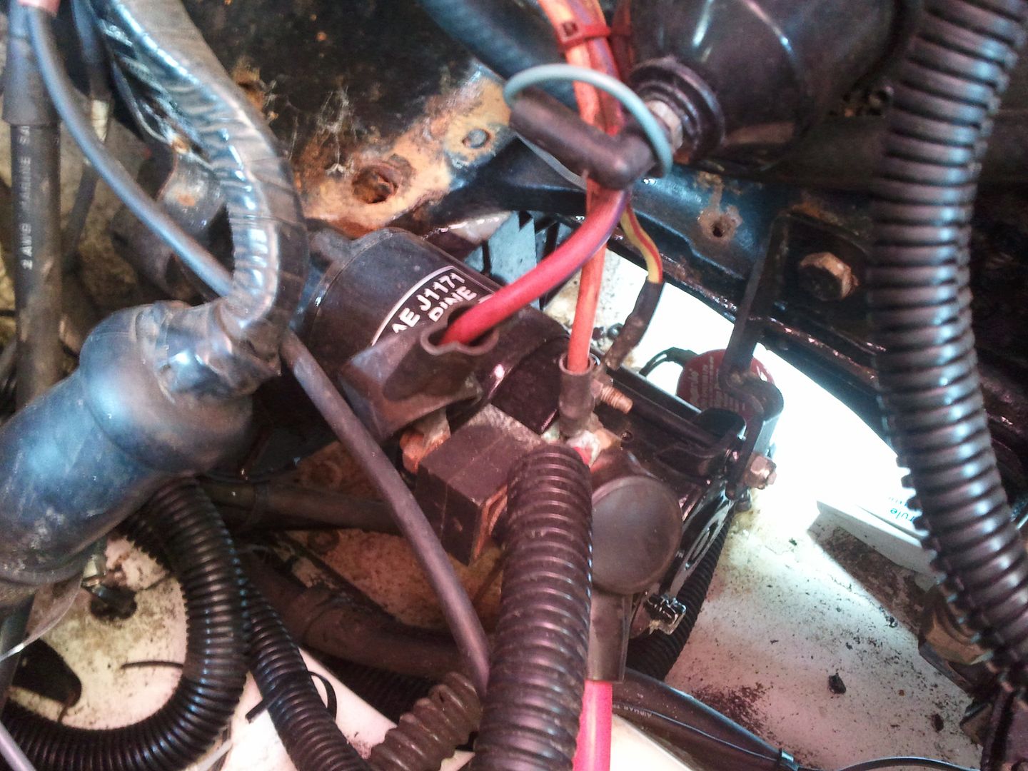

I know the starter, from working on cars. I assume the smaller part is the solenoid. I dont know what the part up on the block is.
I get 12v to the big red wire on the starter, and 12v to the smaller two that are connected to the same stud. Im assuming those go elsewhere to power other items. There is also what looks like a relay on that post.
There is a small yellow wire that goes to the part on the firewall. it has switched 12v when i turn the key. there is also a small ground wire.
one of the wires from the big post on the starter goes to the bottom of this piece on the block. it also has 12v. When i turn the key, the other large wire turns on, but it seems its only getting 6-7v. that seems to be the wire that then leads to the switch post on the starter (smaller yellow wire), which also shows 6-7v.

OK. service manual says that part on the block is the "starter slave solenoid". I can only assume this should be reading 12v in and out when i turn the key.

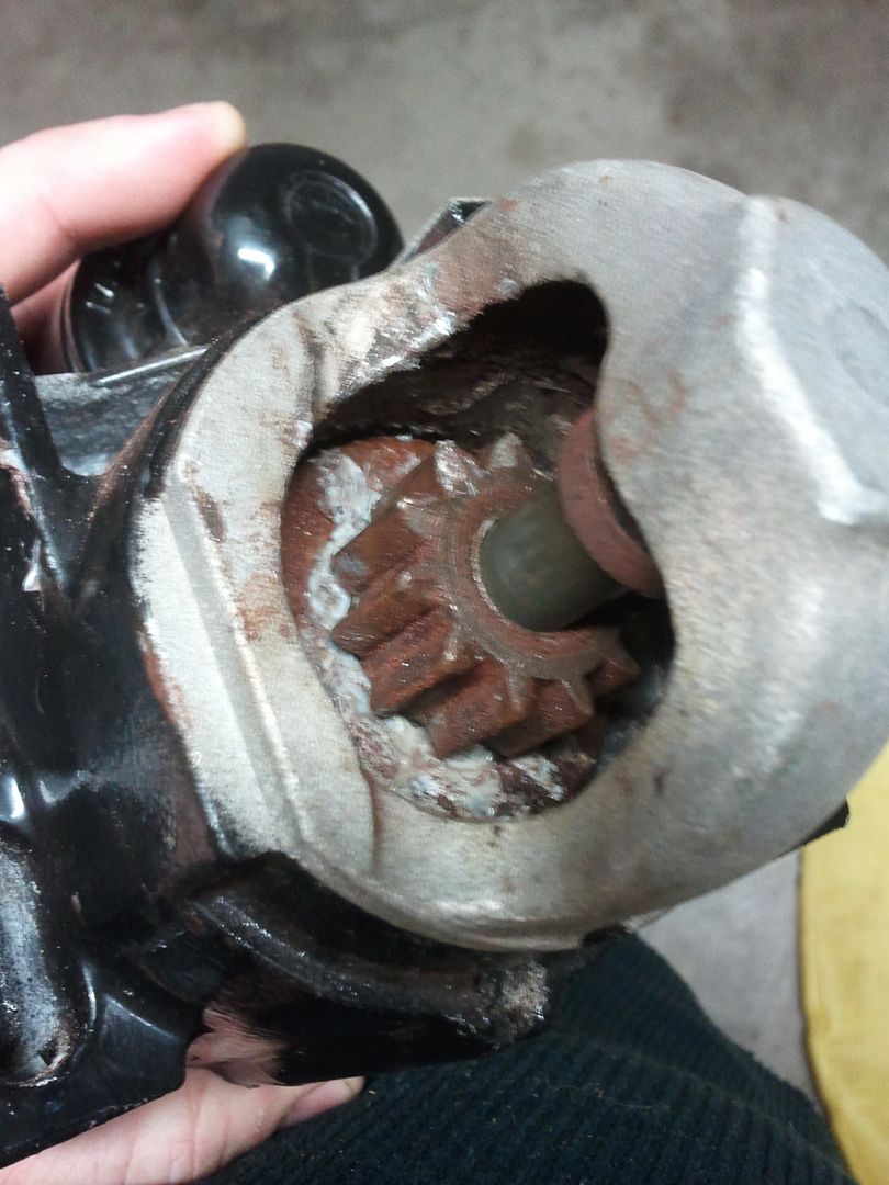

well... i pulled the starter to test it, and it looks like that is the problem. I can move the throw out gear, but it wont spin, even with the help of a screwdriver.
I was trying to reconnect the cables to test it, and the stupid lug broke off. So it looks like ill be replacing it anyway...
you can see in the pics, its pretty gnarly in there.
and the damage.
