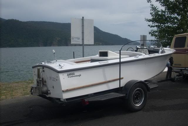

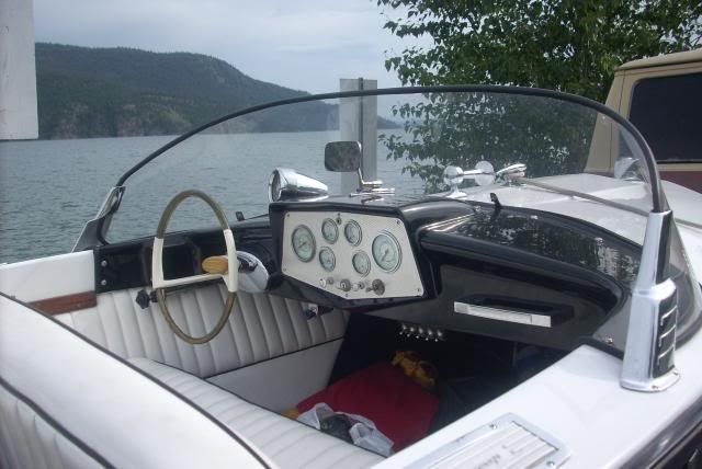

lol....i dont want this to turn into a doom and gloom thread.
as a guy that works on boats all the time, and owns a repair shop for exactly this problem. let me throw in my 2 pennies.
there is no such thing as a waterproof boat. aluminium or glass.......rotten stringers are the evidence of this. and in the case of an aluminium boat......even a welded alum hull can waterlog the foam. there are several threads in the dry dock right now about it.
even the totally sealed Boston whalers, with no wood, completely foam filled, can waterlog.
this can happen for several reasons. condensation, leaching, can even start this process.
water is every where on this planet.....even in the air. water, or moisture, is the breeding ground for the fungus that we know is rot.
the best cure, is to keep the boat covered....a garage works well.....even a tent. boat covered, bow up high, and leave any access to below decks open.
i have seen 60 year old boats with no rot...no bad foam.
generally speaking, a boat with basic care, will can outlast a car.
this is a pic of the first jetboat brought into canada....it has never been restored.

Wow, love that boat Oops!
