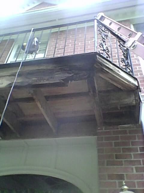

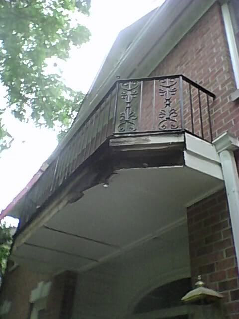

Wood rot has been the theme for me the past couple of days :
I am convinced that wood has to stay wet continuously for awhile to rot. As you can see from these pictures that some of the wood on this million dollar (1.243) to be exact, is totally gone while the rest is solid - it has no resin on it. The boat is a 1982 Wellcraft 248 fisherman. As you can see, most of the wood is gone; rotted out - but the rest is solid. Air has moisture in it, but just being exposed to air is not enough to waterlog, and cause rot; the wood wont wick up the moisture to saturation from the air.
Whether your boat is trailered or not is huge. I beleive that my boat was poorly done by the factory as far as the stringers, and deck goes, but it still had sound wood in it! They put the money in the teak trim, and hull. If your stringers are encapsulated - they wont rot. I know if I live to be a centurian, mine won't. I will encapsulate, the boat will be on a trailer covered - so I agree.

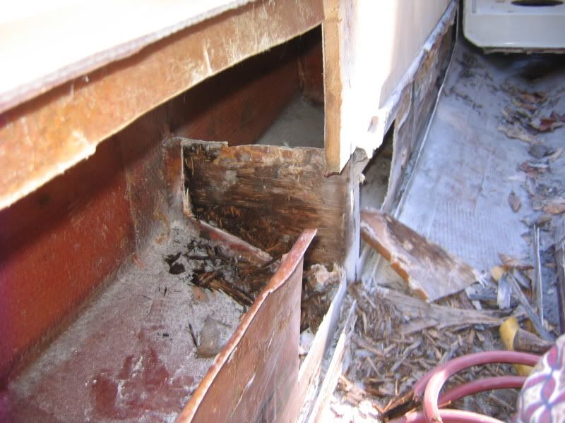

Now thats why I installed honeycomb stringers!
The original stringers in my 44 year old boat were softer than sponge..
transom too.
Strange thing was, the deck itself was absolutly perfect.
anyway its all honeycomb in there now,Screw the rot!
