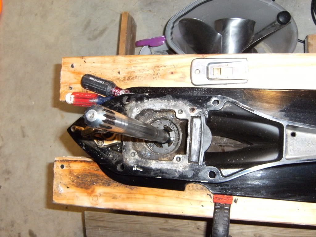

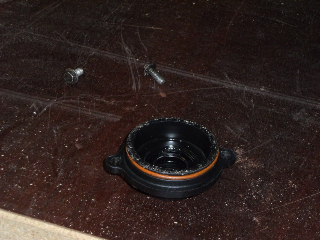

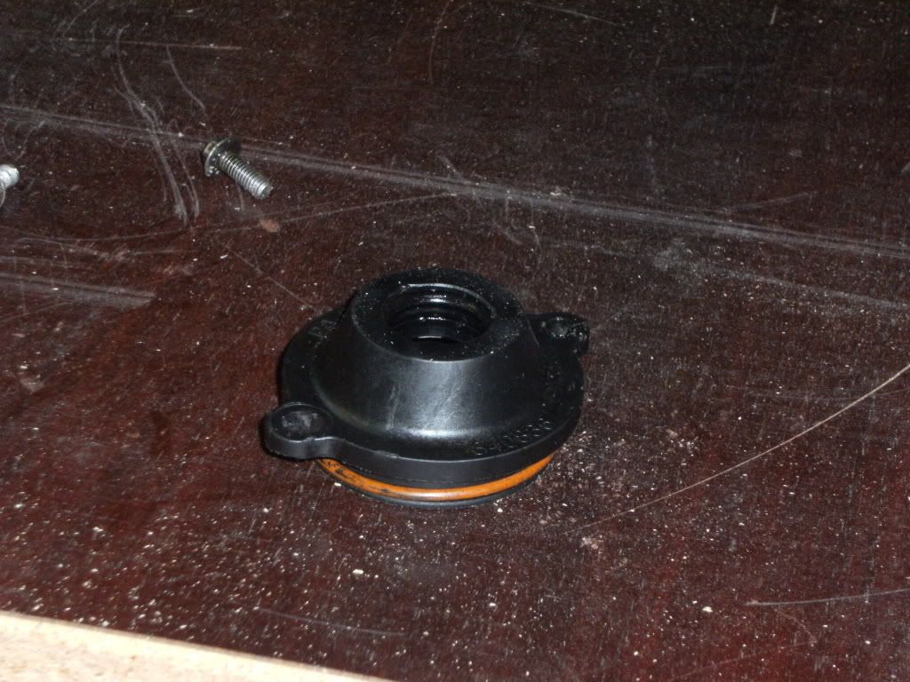

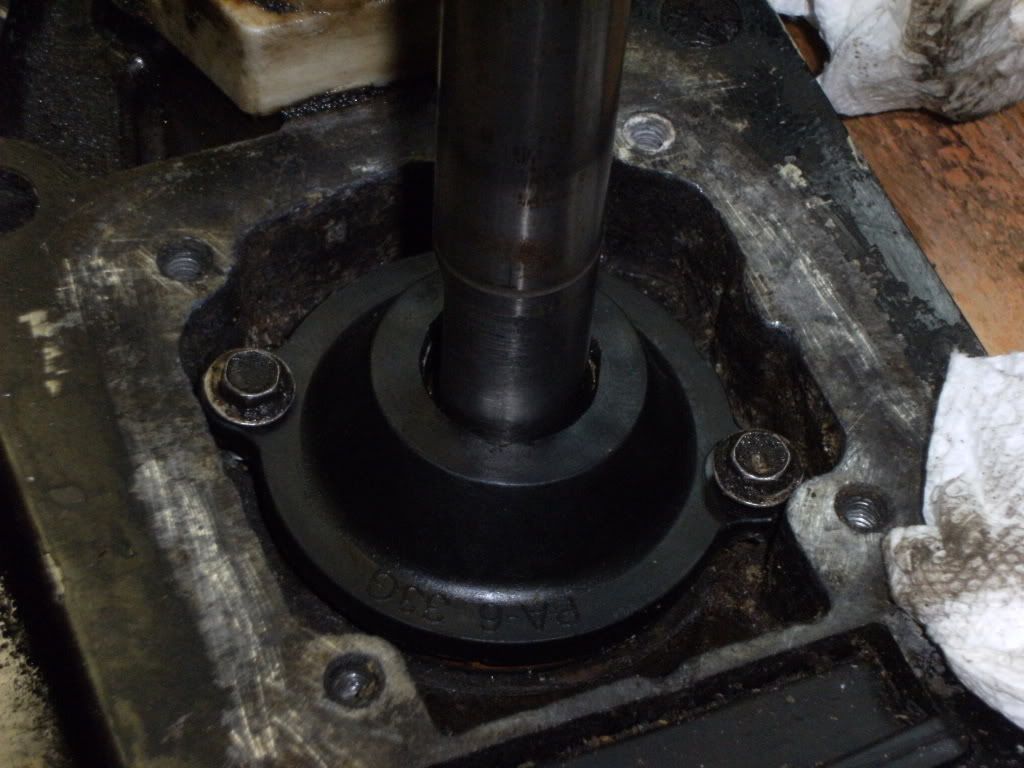

I have an alpha 1 gen 2.
I would like to replace the seal under the waterpump but this seal assembly does not look like the one in the parts maual when pulled up by serial number, they are similer.
The one in the unit has two tabs with holes in them. The holes alow the seal carer to be bolted to the lower unit.
I am trying to understand why this part is different, what part I need.
I had the part pulled up at a parts suplyer by the serial number. The piece they wanted to give me is different than mine.
Thanks
Chris
Not sure what you are referring to, that carrier is not bolted in any of the versions. Do you have a picture of what you have?

Re: Alpha gen 2 Seal under water pump different.
pics have been added. Thanks Chris
Hmmmmm, never seen one like that before. What is your drive serial number.
Drive serial number is OF175992 on the upper.
The seal has the numbers PA-6 33G and 840836 on it.
Is there a number on the lower and if so where is this number?

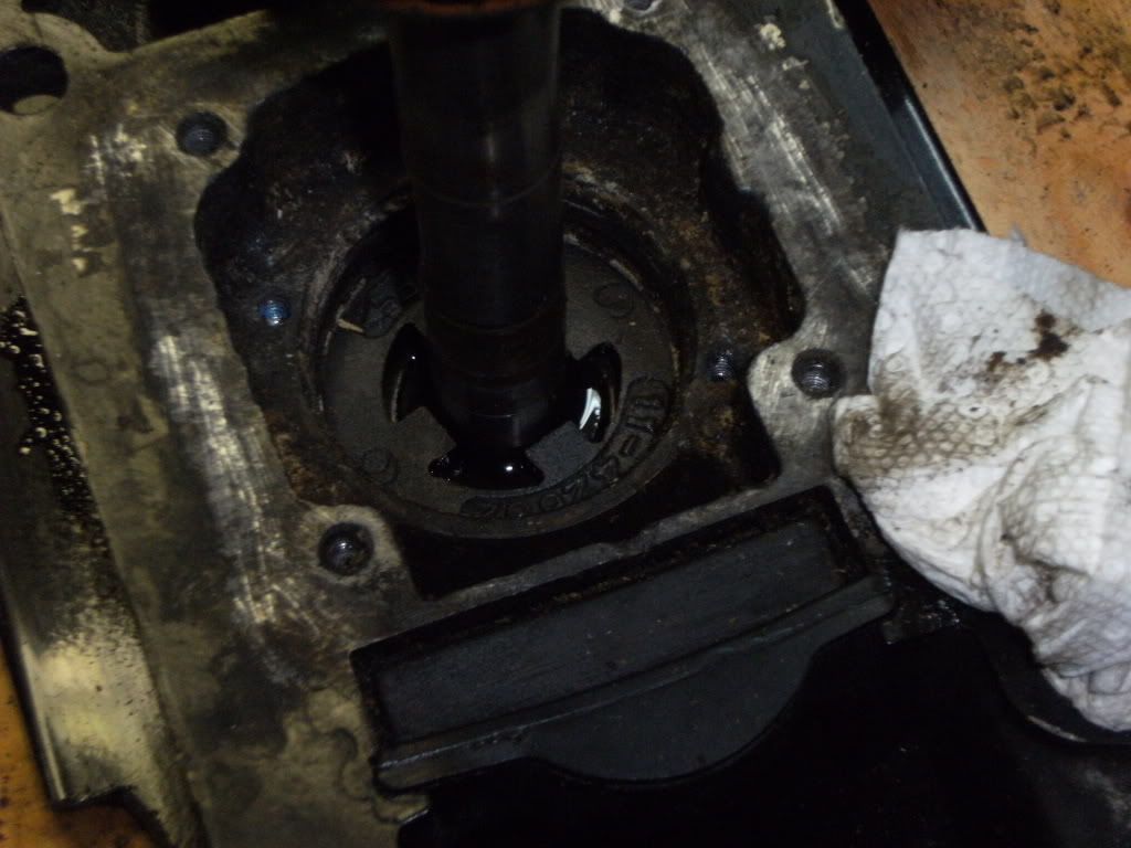

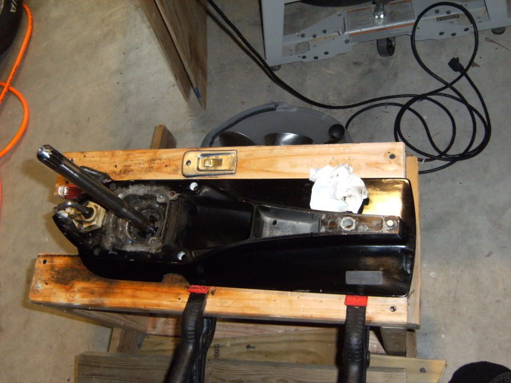

Take another picture of the whole top of the lower unit, and remove the rag. There should be a hole there for the oil passage. Is there a vent plug on the upper, port side of the lower unit?
I have posted the requested picture.
I found the bearing carrier is used on a number of Outdrive units and the two seals part number 66302 were used along with one O-ring number 90011.
Further I found several alpha 1 gen 2 use the same seal and O-ring.
eg a Mercury Marine : ALPHA ONE (GEN.II) 1996-1997 0F680000 THRU 0K999999 (MERCRUISER)
I am hoping I can put these seals in mycarrier and It would work.
If anyone has any thoughts I would be interested.
