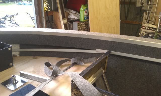

Deck, side and gunwale carpet is in. Old trim is on the bottom now. New trim for top is 1x1 1/2, should have just gone with 1x1, but too late now. We'll shine it all up, break that corner some and pull the screws out and replace them with pop rivets, we used the clamps and screws initially to draw it all in tight. It did NOT want to take that bend. 1x1 would have been easier to work with and would have covered plenty. Will wanted to replace the piece of carpet on the s-board gunwale but I put the trim on and now we don't want to pull it off. The glue would not hold on the colder day and it puffed up in a few spots. If it doesn't lay down I'll poke a little hole in it and shoot in some head liner adhesive.
