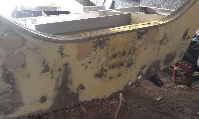

Sea Nymph rebuilders take note, if you are adding carpet to the gunwales the trim/rubrail track is not necessarily made to allow for the thickness of the carpet. We had the first of a few compromises here tapping the trim on as far as we could and screwing it fast. It has a little bit of a downhill cant, but the alternative was pulling the carpet off or trying to cut the carpet right up to the trim. I chose this as the least tedius route.
Ugly transom with new angle aluminum trim cap. It is one piece of 1/16 sheet aluminum trimmed with this Stanley aluminum angle from the hardware store. It bent fairly easily and cost $6 each.
Trim looking good, the screws from the center piece will be removed in the Fall when we refinish the exterior and the gap filled with 3M automotive seam sealer.
Transom looking a little more presentable, 3 coats of Krylon rattle can, it's good til November.
