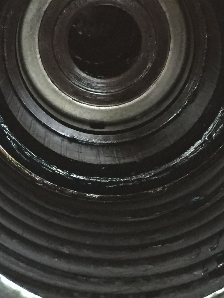

And I can't see any wear other then the grey material inside the race. On a side note, I got tired of lifting this heavy beast and made this out of one of my wives palettes.
Ayuh,.... Post a picture of the castin' where the bearin' goes,....
It's supposed to be a resistance fit,...

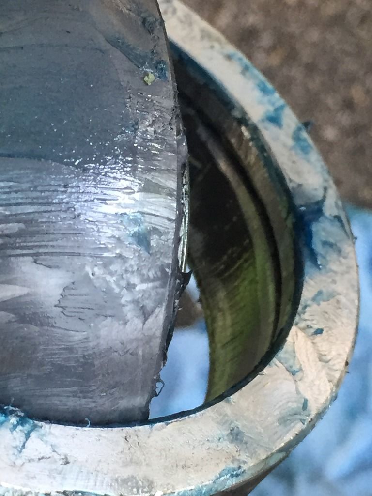

That's the grey material I was talking about. The bearing is very loose in the outer race.

The first 2 pics do not look like the proper gimbal bearing at all, while the third looks like a gimbal rotated 90 degrees to the carrier, but I can't tell if it is the correct one. Puzzled as to what is goin on here... Do you have the correct bearing in there?
alldodge
Mar 8, 2009
44,640
Agree with Bababouy, that doesn't look like the sealed gimbal bearing. The other problem may be because its a GLM product.
What are the numbers on the bearing? Looks like 4C0635

The bearing came in a kit that I bought to do the the bellows. I thought it was a Sierra bearing but now I'm not sure. The kit just specifies alpha 1 gen 2. I'll have to look at the part number when I get home. The new bearing I have on order is sealed oem one.
alldodge
Mar 8, 2009
44,640
The bearing doesn't "appear" to have enough shoulder on it, should resemble this gimbal bearing.jpg
The shoulder should be on both sides to help keep it centered on the shaft, also help timt
