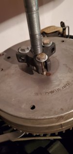

The flywheel is resisting me today. I need to bring home a big bolt for my puller.

these harmonic pullers work pretty good.. the inverted nylon lock nuts are used as limiters so as not to screw the bolts in to far in the FW and scrape the coils. They also keep the bolts from getting lost :)

I only have a large wheel hub puller and the flywheel bolt diameter is only a couple inches. I found the center hub of a 3-jaw puller was just right but this is from a slide-hammer set and I can't get enough torque on the handle to push the end of the crankshaft down. Gotta stop & buy a M16x1.5 bolt to make it work.

How do you hold the flywheel from rotating without any risk of damaging it?
I use a 1/4 inch impact driver on the big bolt . the weight and inertia of the FW allows the extractor to pull up the fw without the FW rotating
