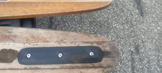

As part of a "free" 1976 Starcraft Montego 16 Tri-Hull Ski Boat I was gifted, I received several ski tow ropes and a couple pairs of skis.
The ropes I've gotten settled out- a couple are good to use (one of which was attached to a transom cable system that's a bit worn), one was good OK until an animal got in the boat and shredded the foam handle off.
The Skis on the other hand are hard to say:
One pair is a set of D!ck Pope III skis that other than some bubbled labels, seem to be in passable shape:
The other is a set of longer D!ck Pope Jr. skis that were left in the ski locker, which unfortunately had a lake festering underneath it (see thread :eek: ) and as a result, the clearcoat and inner glue is shot with some rot starting as well:
Gosh knows how old they are... family owned the boat since it left the marina in 1976 (and I found foam life jackets in the boat as old as 1989 :poop:)
At the moment, I'm not looking to ski (will use a tube and related ropes also included for initial testing)... no rush here. That said, I'd like to know if either set of skis is worth fixing/using, and if fixing, how one would fix such. My gut feeling is that the III's are usable but the Jr's are firewood due to the water damage (especially the rot). But I have no idea what I'm looking at.

most people just send them old wood skis off to land fill , however , i have a pair that i have saved / restored for my man cave wall.
restoration is a big job and in retrospect not worth the effort monetary wise , but the do look great on the wall.:).

Noted. One picture was out of sequence... the mildew'd rubber is on the Jr's (the III's are spotless).
May hang onto the III's since as far as I can see, other than being old/heavy and the labels being junk, they're at lest usable. Not looking to spend $150-$300 on sports gear I'm not sure I want yet. But if that weight (and the skis being short) is enough to make them comparatively unusable... then I dunno.
52,751
The skis need restoration if you plan to use them. The wood is splitting at the glue lines. Which means they will split on you if you try to use them. Which usually results in an injury
Mildew is easy to address
However wood skis make better wall art than skis. Being wood makes them probably 45 years old or older.

since you asked how to fix them......
de-rig the skis (take before pictures)
then using a DA, sand down the old varnish to bare wood. I start with 180 grit. if you are careful, you can use a heat gun to remove most varnish prior to sanding.
the splits are fixed by prying apart the split, cleaning out the inside of the split with oxalic acid (wood bleach) to kill any bacteria and compressed air to remove any dirt and debris.
a good clear, repair epoxy in the crack, clamp the wood together and use tape to keep the epoxy in the crack
to take care of the rot, you need to use a router, remove the rot, and then make a wood plug that fits exactly. use the clear epoxy to glue the plug in.
then sand the surface to 240 grit.
apply 3 coats of marine spar varnish, sanding between coats
last coat gets buffed
re-rig the skis.
now you have shiny 50 year old skis that you spent 100 hours on restoring.
or mount the old skis on the wall of the man-cave or garage since they have been in the family for 49 years...... go on facetube racketplace, find a set of composite skis that are 20 years old for $50 and buy them. you get much newer skis for a lot less money.

I cut my skiing-teeth on skis like that. I still have two pair.
If you restore them, understand that while you can ski on them they really don't perform any where near as well as the more modern design. They're a little heavy on your legs maneuvering and the rudders don't give you the control you get from the new stuff. Fun for a retro-ski, and cool lookin'. But if you start to slalom or anything like that, you'll want some newer skis.

The old Richard Popes from the 60's and 70's were a higher quality wood then the 1980 ones in your pictures. Restored Cypress Garden skis are all my family uses even though we also own a more modern pair of O'Brien and Connelly skis. The old flatbottom wood skis have a lot less drag allowing you to ski longer and will turn just a sharply as the tunnel concave glass skis. Also much easier to start with. We save the glass skis for slalom skiing. Even my trick (banana) skis are wood Cypress Gardens, "Trick Masters".
