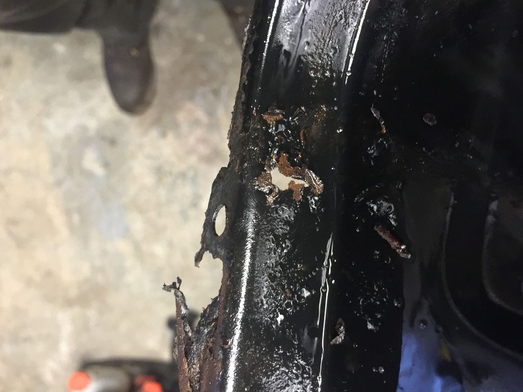

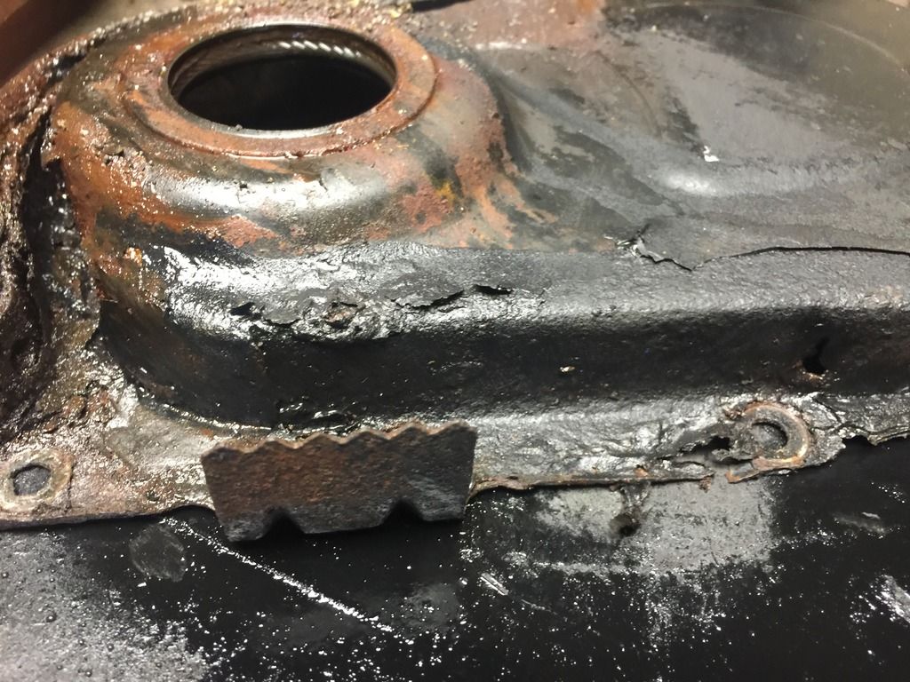

Well figured out its NOT the water pump leaking :(
The timing cover rusted thru from the water pump leaking previously
I will get a new timing cover, seal, and belt
Why didn't they make these out of composite or some other sort of material to avoid this?
To much surprise the oil pan gasket stayed competely intact I will apply a real thin layer of "the right stuff" upon install to avoid any oil leaks

I thought the proper way of replacing the timing cover was to remove the pan. I have never done one but that is what I have read.
bruceb58
Mar 5, 2006
30,796
I just looked in my Volvo manual for the 3.0 which is the same engine and it says to pull the oil pan too.

Yes, I have read a bunch of mixed reviews of doing the job.
I'm 99% positive I cannot remove the oil pan from the boat to replace that gasket as well, unless I can lower it enough to drop the pan and replace the rubber gasket? It seems there should be enough room to do that.
Almost like the same thing as doing the water pump seal on a 470 you have to remove the cover which exposes the oil pan gasket which I believe is the cork gasket this being the rubber gasket I think I'd be OK not 100% sure though
I did loosen a few of the oil pan bolts towards the front of the pan

I have done the "replace the pan" in the boat. I would never do that again. Way easier to pull the engine and do it where you can get everything easily.
With your engine, you could get it out in less than a few hours assuming you can get a lift.

I am pretty confident I will be able to get this to seal up the way it is now, worst case I will pull the motor if I have to, really trying to avoid that option at the moment

We did them in the cars all the time. Remove the front pan bolt on each side and loosen a couple back from there. Use right stuff on the joins between the side pan gaskets, the front pan seal and the timing cover gasket. Put the bottom of the timing cover onto the pan. Kind of angle the bottom in. Pry the cover down with a punch or small screwdriver in a bolt hole on each side and slide the cover back into place.
