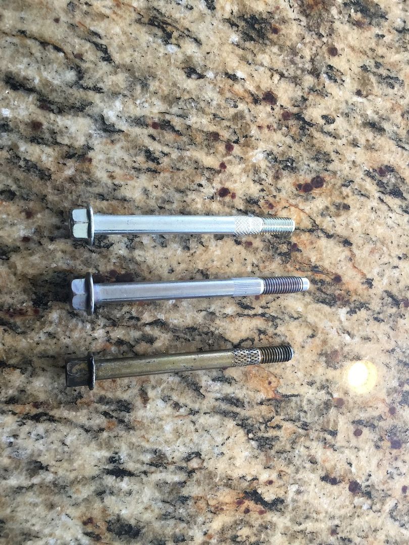

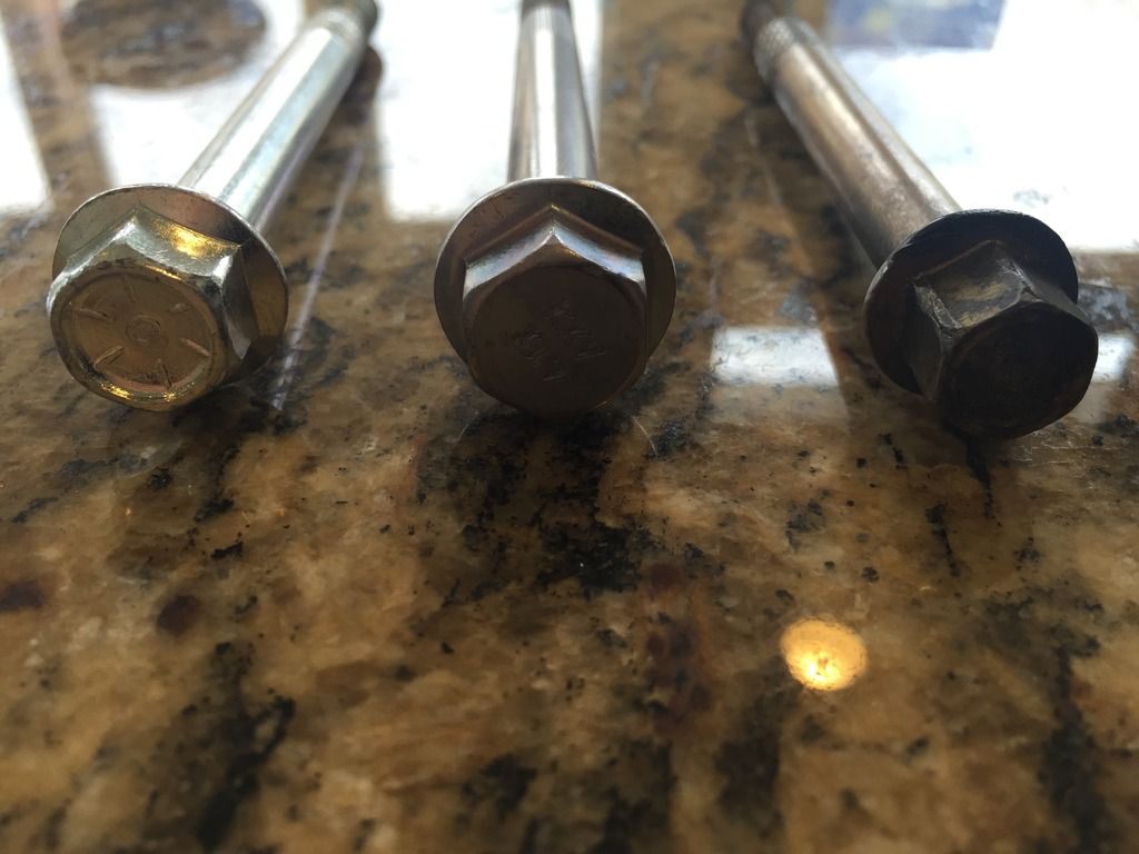

Just wanted to give an update I received the GM bolts today and I am not sure if they will work, the GM bolt head is much bigger than the OEM bolt that came out of the motor, I also have the Dorman bolt, I attached a picture of the bolts for you guys
From left to right DORMAN, ACDELCO BOLT, OEM BOLT THAT CAME OUT OF MOTOR

Ayuh,... Sure looks it,.... The others will still work,...

I'd go with the Dorman. It has a grade 8 spec marking on it. The others may be grade 8 but they're not marked as such.

Are the GM bolts metric? That would explain the 10.9 on the head. They may not be the correct ones. Check the fit before trying them and/or compare them to the original bolts.
BTW, 10.9 and grade 8 are essentially the same.

I still can't get a good read on the GM bolt. But if it is metric, a 10mm is a bit larger than a 3/8 so it shouldn't start into the thread in the block.

I do not have the bolts in front of me but the GM bolt did NOT work, wrong thread pitch....Not a big deal I can return the bolts
