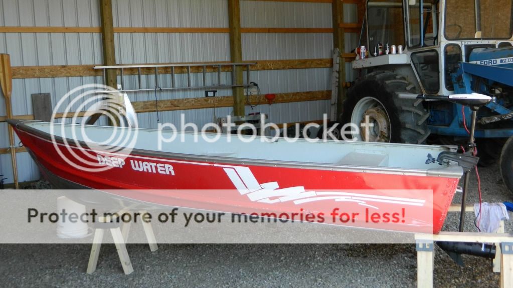

The lake we camp, fish, and boat is fed by a narrow creek, ( where we camp) the fishing in the creek is really good, but I am uneasy about taking the 18 up the creek for fear of running aground. I have been on the hunt for a 12 too 14 ft tinnie. They are real hard to find in my area and carry a handsome price, but today the wait has paid off. After four hours in the shade of the hanger, along with the polisher, and a bunch of polish this is what is going to the lake in the morning.
It needs nothing now that it is cleaned and polished, 1997 Oppolo DEEP Water 12' 60"s wide and real deep, look out Walleye

Nice score Glen. Cleaned up real pretty!

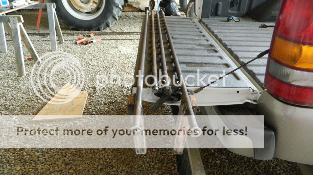

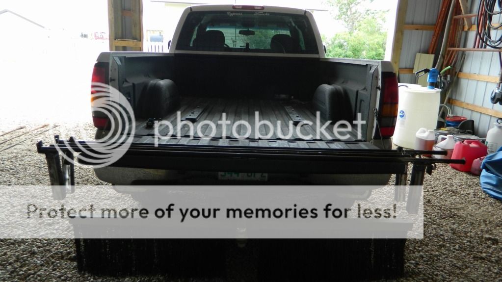

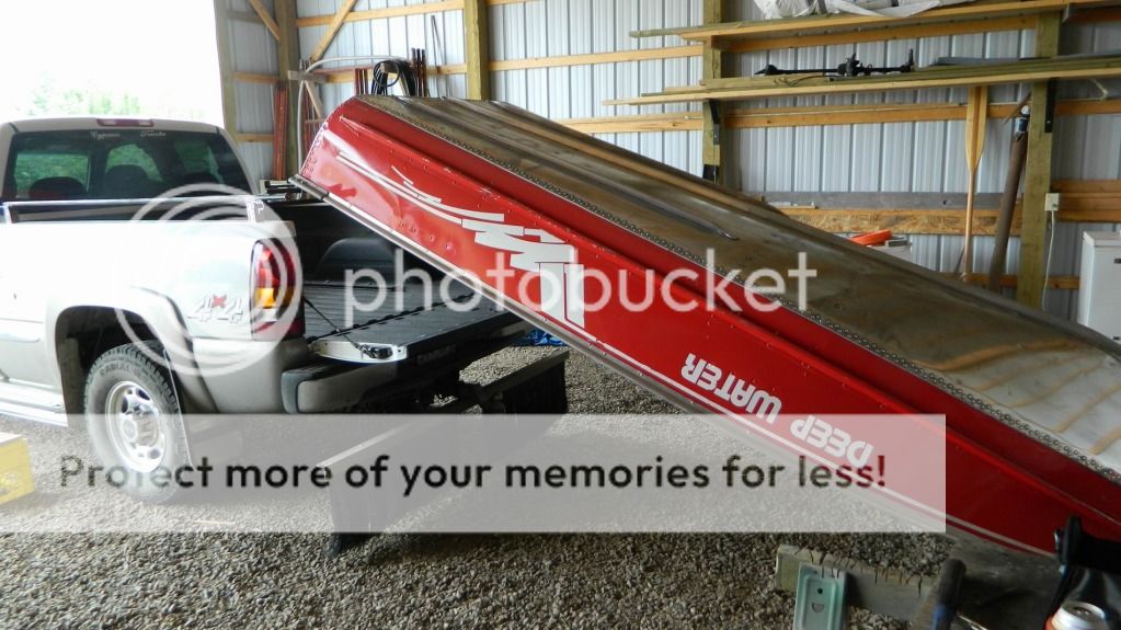

I wanted to build a simple boat carrier for this boat for the back of my short box pickup, and still be able to put all my gear in the box. Plus it had to be easy to put on the truck and the boat had to be one man loadable. This what I came up with, I have $14 in parts and about four hours work. The whole thing is built out of 7/8"oil well sucker rod, 4'of 1 3/4" tubing and 8"s of 3X2 angle. The 1 3/4 is for the stack pockets, the sucker rod is for the slide bars and cross supports, I also cut two 6"pieces of 1"black pipe length wise to make slides to run on top of the 7/8 rod, for loading.
There are four 3" X1/4"bolds that go through holes in the transom corners so the boat stays put on the 7/8 sliding cross brace
Couple more in the next post

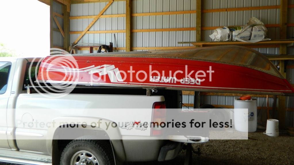

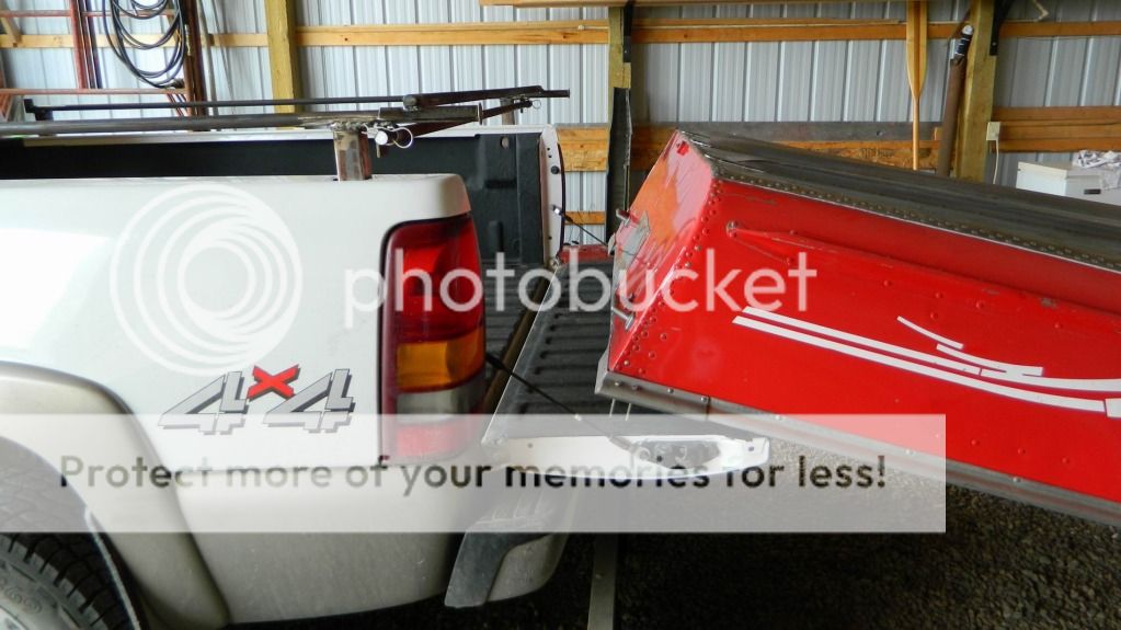

There are only four parts to the whole carrier, plus the 4 four 1/4 inch bolts and 2, 1/8 hair pins for the rear support bar, it all comes out in 30 second and can go back in in the same amount of time. The boat get singed down with three ratchet strapes to the factory installed lugs in the truck box, one on each transom handle and one over the bow.

Slick and cheap. Bottom feeder friendly. Any problems with the overhang from the ticket writers?

that is friggin brilliant. but i agree with GA, ya might want to make up a flag for bow of boat to keep the gummint away
