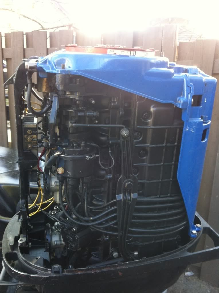

hey guys i just finished putting to geather my first outboard that i got in pieces, and i have no spark and im not sure where to begin. i have tried to test for resistance but have no clue on whats going on i have the multi metre on ohms but its reading 0 on every thing i touch. its a 1978 mercury 115hp inline 6. i put every thing togeather as like the manual shows. thanks,stu.

First check power supply to the switchbox, in your first picture, the red wire should be 12V from the battery, the white wire should be 12V from the ignition switch turned ON.
Read the CDI Guide, grounding the correct wire should produce a spark from the coil. This will verify the switchbox good.
Repost what you find out.
