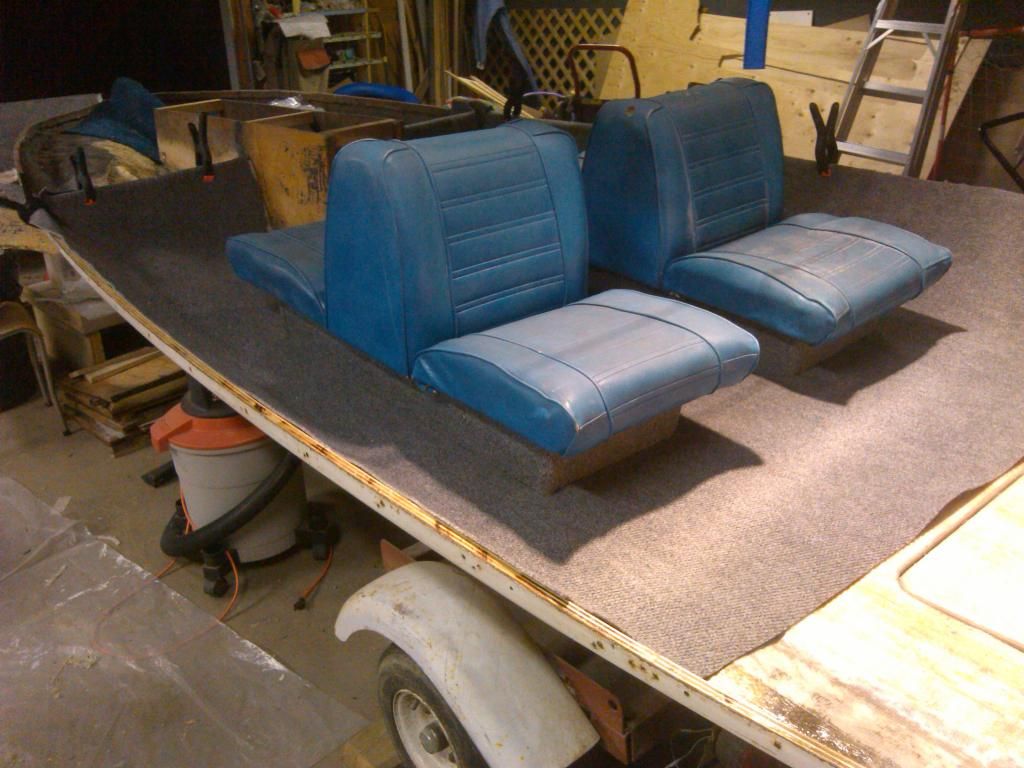

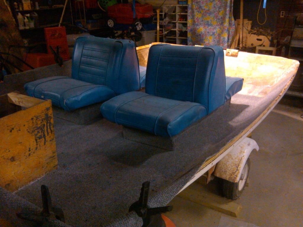

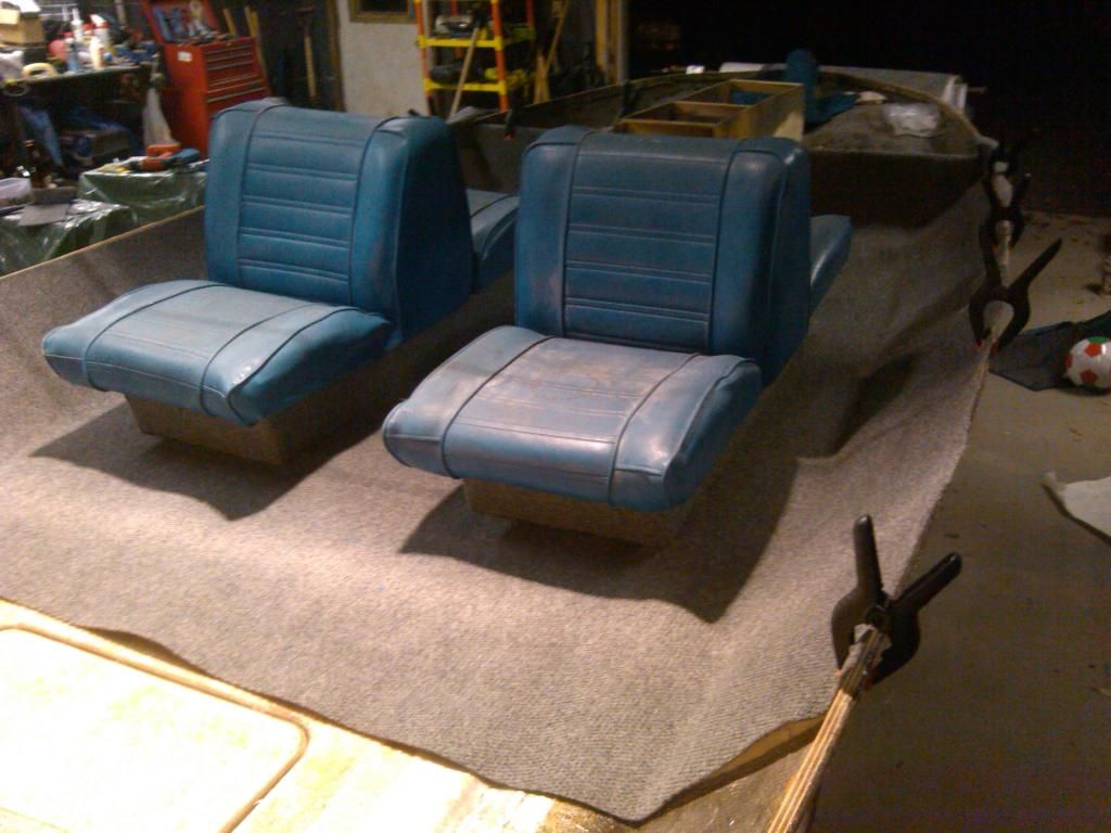

HEY HEY there it is lol so simple but so hard for a rookie like me lol
before
after
My before pics arnt that great but they give you an idea how rough the carpet was and dirty
