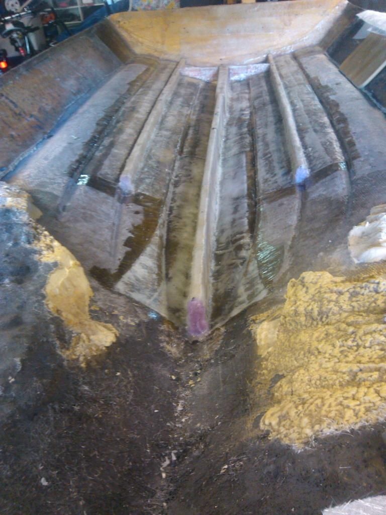

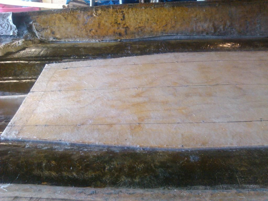

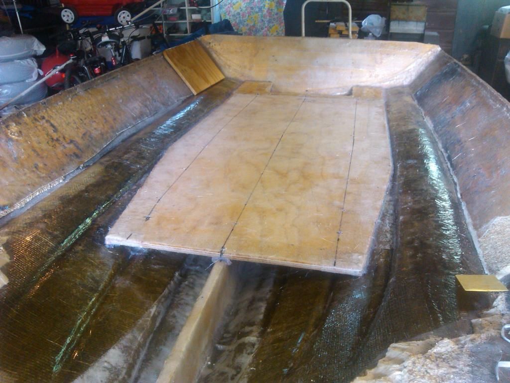

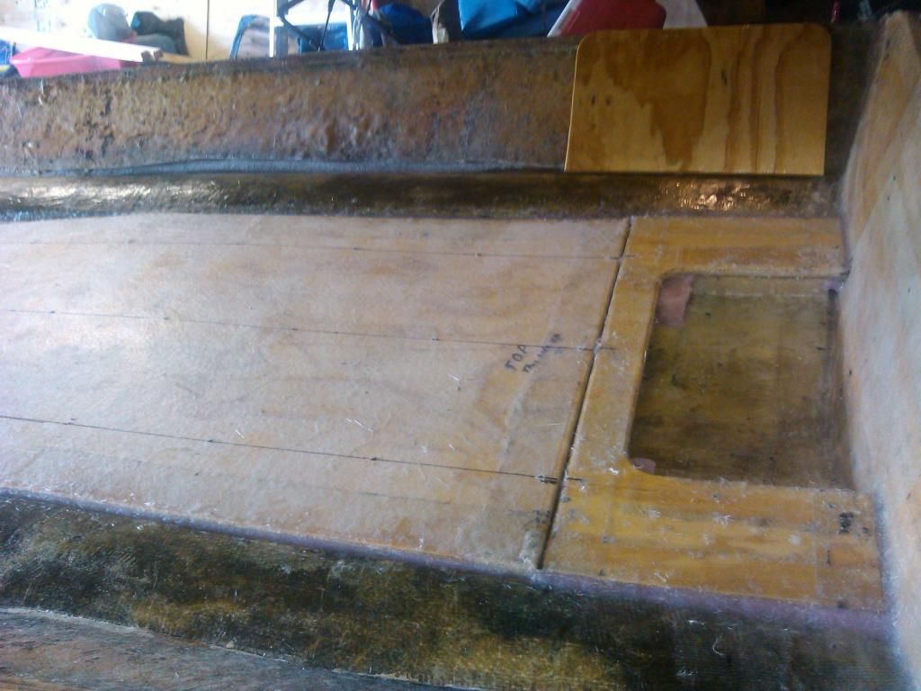

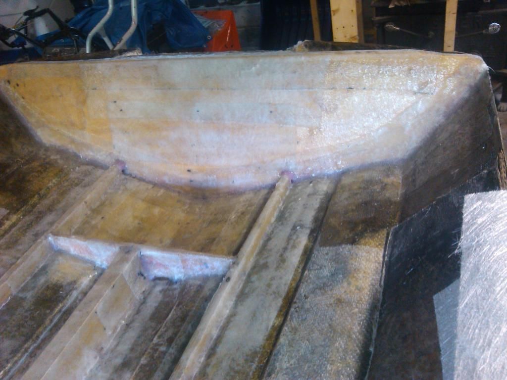

HEY GUYS just wanted to check in here and let you all know that i officially have the transom Installed permanently and she solid like rock lol and the lid fits perfectly.
I also have the the stringers all installed tabbed and solid as well. The other day 2/3 of the deck also got installed and filleted and awaiting tabbing. I'm getting close what a feeling to have stringers transom and deck installed and she looks goooooood.
I have Pics that i will post i just dont have time right now.
Hope all is well with iboats family
banshee owner
Sep 4, 2013
227
finally figured out photobucket
heres a pic of the progress so far ill add more pics in a bit but shes all coming together
