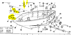

posting the mdl #/ year will help....check the plate
here is a 1985 mdl push down on the rear hood turn handle down when open grease it

Model # or picture MUST be posted.----From 93 to 96 these motors had an oddball / poorly designed latch.

Most likely it pulls down....might need penetrating oil and or heat.

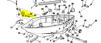

Oh man thanks but that is older I think than my engine. Mine includes electric start (wires coming out of the front lead to a rusted terminal block in the boat). I'm pretty sure the handle is lever hinged toward the front of the engine, so it would pull up and forward to remove but it is frozen in place. I'm about the try forcing it or drilling a hole near where I think the hinge is and squirting in WD40.

That is a 77 model.----Latch is under the cowling at the rear , just pull it down and cowling will fall off.

DUDE that did it! Opened right up. Nothing seems frozen or corroded (light patina). Looks pretty clean, considering It's probly been out there for years in the weather. Now I'm looking for a gas tank to connect to it.
