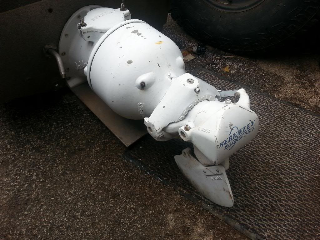

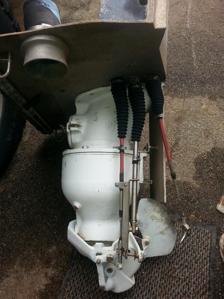

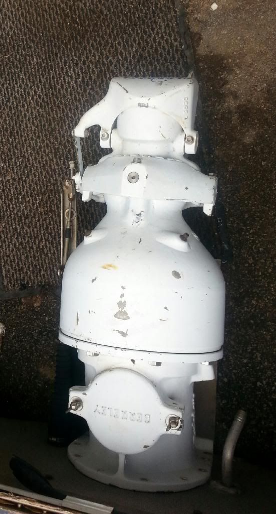

Well i bought the thing some bonehead did a little clearancing on the tilt yoke. I am not sure whether I have a place diverter or a Jet-O-Vator so if any of you could set me straight that would be cool. I did get a section of the hull it was attached to so I can figure out how to fit it to my boat.
Bondo
Apr 17, 2002
71,418
Re: Berkeley JE series jet for my boat
Ayuh,.... It appears ya got a JF, with the reverse bucket,....
Ya can't put a jet-o-vator on those pumps,...

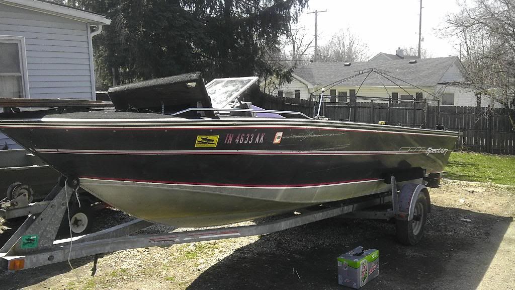

If you look at it close you can see it has the tilt yoke for the nozzle. I don't think I'll need a jetovator or pd. Thanks on the I'd confirm. Has anyone here got a guess on the speed I could get out of this thing? I may look at switching over to a sbc for power.
This is what I will be putting the Berkeley in 1990 Blue fin Spectrum 19ft. Not typical for a Berkeley I guess, but I think it will be the perfect for what I want to do. I will not perform the conversion until next fall /winter since I need to plan to make this work well.
Nope,... It has the swivel for turnin', 'n a reverse bucket,...
What yer callin' the tilt yoke, is the Reverse bucket,...
That pump can Not use a place diverter, not a jet-o-vator,...

The nozzle goes left, right, up, down. in addition to the reverse bucket operating. Someone has hacked the tilt ring to get more angle out of it so i guess I'll be able to put fires out on shore now.
