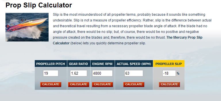

63 MPH with a 19" pitch prop on a 1.62 outdrive at 4800 RPM is a NEGATIVE 18% prop slip! In other words, your boat is going 18% faster than the prop is turning .....
In other words, at least one of your numbers is wrong.
Is your speed from your speedometer or a GPS?
5% prop slip (which is still almost unobtainable without dual props) would give you 51 MPH. Zero prop slip would give you 53 MPH.

Even using 1.5 gears in your boat (most common with a V8) shows negative 9% slip at the conditions you describe. A realistic number would be a positive 10% slip. With a 19" prop at 4800 RPM, that gives a top speed of 52 MPH with 1.5 gears or 48 MPH with 1.62 gears.
To evaluate any benefit you might gain from changing props on your boat, you need to know the true speed (use a GPS) and actual WOT RPM that the boat delivers with the current prop.
Without knowing those, you're wasting your time (and money) even thinking about changing props.
