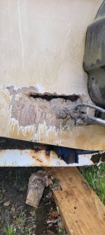

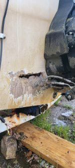

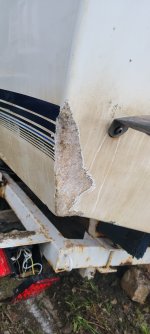

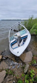

Sadly the water came up 16" over night combined with a bunch of white caps which resulted in my boat coming off the lift and washing ashore. These two spots are the worst of the damage. What are your thoughts ?
Thanks!

So the water came in over the side of the boat as I tried to push it back out into the lake. I would say the boat filled up 1/3 on the angle. We got it turned around and pulled the plug.

Do you have insurance? If so I'd contact them first, the damage looks like it needs to be repaired by a pro, but the water intrusion is quite serious as well.

I was thinking as I saw my boat crashing against the rocks... why don't I have insurance. I'm honestly super handy and feel like if I have to pull the stern and the motor, cut out the transom and redo the fiberglass I'm down. But I'd rather reach out to pros to see if you guys think that's necessary.

Man, thats really unfortunate... In my opinion, if you're planning to do it yourself, I would pull the motor, drive, and transom assembly... you have a hole in your boat from impact, which means you probably have stress cracks propagating much further away that you probably can't even see... The whole transom is probably compromised..
I'd say you should probably redo the whole transom, both inside and out... Its a lot of work
52,787
that transom doesnt look good. looks like the rocks ground away the fiberglass exposing a rotting core.
if you have insurance, find a different boat. Especially if its salt water.

I will drill holes and see if the transom is rotted aswell as do a stress test on the stern to see if the transom has flex when I put weight. I'm not afraid of pulling the stern and motor. I've done it before in a couple hours.
