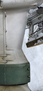

Hello to all from Northern Vermont, hang in there spring is coming!! Well, I came across this boat and engine for sale (price was not specified in the add) I didn't think much of it until, I saw the what make (year unknown) the engine was. A 40 HP Evinrude twin cylinder engine, tied to a 15 (or 18 foot Starcraft boat) with trailer. The previous owner had passed away, and the seller knows nothing about boats or engines. So this 40 HP Evinrude looks to be a 67 68??? Seems to be all there, compression seems to be there as well, but the boat needs some TLC but again, it's all there. Now I already have my boat with engine and everything works 100% so I really don't need another, but I offered this guy $500 and he accepted without any thought. My thinking is, get the engine for parts ( or a spare ) if it's close to my 1968 Evinrude 40 Hp. What do you guys think? I mean for $500 boat, trailer, and engine, even for parts, worth it??

$500 to haul it away would be more appropriate
Uncovered
Full of snow
Bow down
Fiberglass boat
Just 4 big red flags after brief scan of pix, there are likely others

If the engine is actually compatible with yours, then it might make sense. Heck, it even has a prop on it, so even without the engine possibilities, you could sell parts off the hull (chrome, windshield, and shifter) and the trailer- maybe even sell the trailer outright or convert it into a flatbed.
As far as the hull, as it sits I‘m afraid it’s a lost cause because it’s been exposed to the elements for awhile. That will quickly rot out the structural stringers, transom, and deck. If you have the time and patience it could be repaired but it’s rarely worth it.

It was a wonderful motor when new.----Electric shift with generator.-----Model # is found above the transom clamps or on the starboard transom bracket.----Find it and post it.-----There could be a lot of work to make the boat usable.

If it truly is an Evinrude (white), then it is a 1967 Lark Electric shift. There are some $$$$ parts in it. The shift switch in the remote control comes to mind. But we don't know if it is any good. Feeling lucky?seite_08_09.jpg

Motor will need a complete evaluation before spending beer tokens on it.---Compression test.-----Ignition coils.----Carburetor clean.-----New impeller ----Type C-gear oil ( premium blend ) for lower unit.-----Oil container must say " for electric shift " on it.

A 40 HP electric shift is not a rare motor !!-----They built lots of them.

By the looks of the fishing line on the lower unit you have to wonder if the previous owner looked at it or did maintenance ?----Yes they are a nice / simple / easy to maintain motor.-----Even the electric shift / reliable is simple for me.

Lark is the name for the electric shift with generator model.

The control only has a throttle cable.-----Will not work with a standard shift motor.

Hmm...well good question it looks to have a "Brown" cover to it and the engine itself was not white, but it def was an Evinrude, i'm heading back over there in the moring to give the guy a deposite so and i will do some more digging around and post more on it what i find
