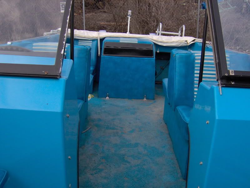

Re: Bow Walkthrough
Zup,
here you go, please over look the dirty carpet :) but there is three snaps on each side of the consols and velcrow on the bottom of the fold over window, the curtain is just made out of vinyl to match the rest, then when not in use it folds up in the side pocket.
it really dose not need to be fastened on the bottom.
hope this helps
woosterken
