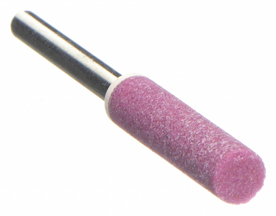

My daughter snapped an engine mount bolt off in the block of her jeep. I tried everything to get that stupid bolt out. Finally wound up snapping an easy out. I searched forums for days and finally found that chainsaw sharpening stones will cut through just about anything. I grabbed a few and used my dremel tool and was able basically grind the easy out enough to drill a straight hole down the middle of the bolt and used a helicoil. Sometimes you might be able to just re-tap the hole. that is the only way I got it fixed. $10 and lots of hours, but it was better than a new block.

So After that failure I decided that stupid bolt wasn't going to beat me so I bought several packs of chainsaw sharpening Dremel bits based on rad1026's recommendation (thanks mate). Several hours of slowly going at it with those bits and a punch to break the easy out i finally get the easyout out. It took 6 bits. I kept going at it and noticed more metal pieces falling out. Then I realized, whoever tried before me had broken a large drill bit out and that is what I have been attacking and not the bolt.
No wonder it was so tough. So there was a broken easy out inside a broken drill bit inside a broken bolt lol. Like Russion nesting dolls.
Another hour or so and I ground that sucker out. After that, a few thin walled bolt shell finally came out. Most of the threads, maybe 70%, are actually in tact. I'm going to run a bottoming tap to clean up the threads on Monday but I suspect I'll still need to drill it out so I can install a 3/8-18 Helicoil.
Anyway, I would NOT like to do that process again, It was a pain but worth not having to trash an engine block.
