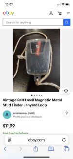

I still used my grandfather’s magnetic stud finder
up until 6 months ago when someone walked off with it. 😡 it was very handy in old home with randomly placed framing. Such as my house which started life as a 600 sq foot chicken coupe in the 50’s I have added on over years and Im up to 1,400 sq now. But it was really handy for the old lath and plaster walls which I deal with on a regular basis in the buildings where I work. They were all built in the mid to late 1800’s. I guess I should look for another one some day and see if anyone still makes them. If any one knows let me know.
tphoyt
Jun 10, 2010
2,419
Just took a look on flea bay. No luck but it was very similar to this one only it was a red case and more rounded.
