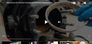

I am installing bearing, But I cannot find the oil hole. Is that new style without hole? Also which side should be engie side. or it does not matter?
