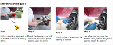

Today I got the gimbal bearing tools describled as following link,
I succeed in pulling the gimbal bearing with some trick. I pushed a stick at the engine size to make the craws expander
For install gimbal gearing, first thing, I have to make a hole on the alignment toos, Really I do not know how to drill hole. also I do not have this tools. Why the manufacture makes this hole at the factory.
But I watch following video at 10:40, he installs the gimbal bearing so easily
Can I install it in my own way showed in

Done. I made a hole in a stick and let the stick do the alignment tools job. Also the stick helped me to pull the gimbal bearing out. It is easier to make a hole in wood than metal.
Is the gimbal bearing right place? I found there is still a lot of space after the gimbal bearling.

Grub54891
Jun 17, 2012
6,491
No. It looks like the gimble bearing isn’t seated in all the way. Using a stick to pound it in on The inner race will ruin it. You need the proper installation tool for the bearing and alignment bar.
