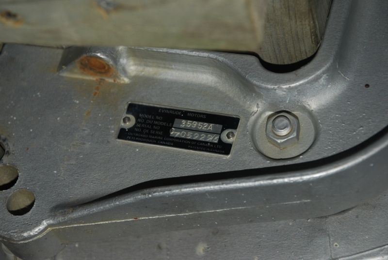

Hello Everyone,
I picked up a Johnson 20hp Seahorse with a seized powerhead (I think), but need to identify the model and year before parting it out (to pay for a boat rebuild). The trouble is, it is a frankenmotor.
The Cowling says Johnson 20hp Seahorse. The nickle sized silver plate has a serial number C0011722. The transom mounting bracket is an Evinrude bracket with model number 35952A, with a serial number 07059296.
I have been able to identify the transom bracket as coming from a '79 25hp Evinrude. I have tried looking up the serial number and matching it to a Johnson serial number, but without any luck. Can you help me identify the powerhead? From the finishing on the motor, the only 'new' part is the transom bracket.

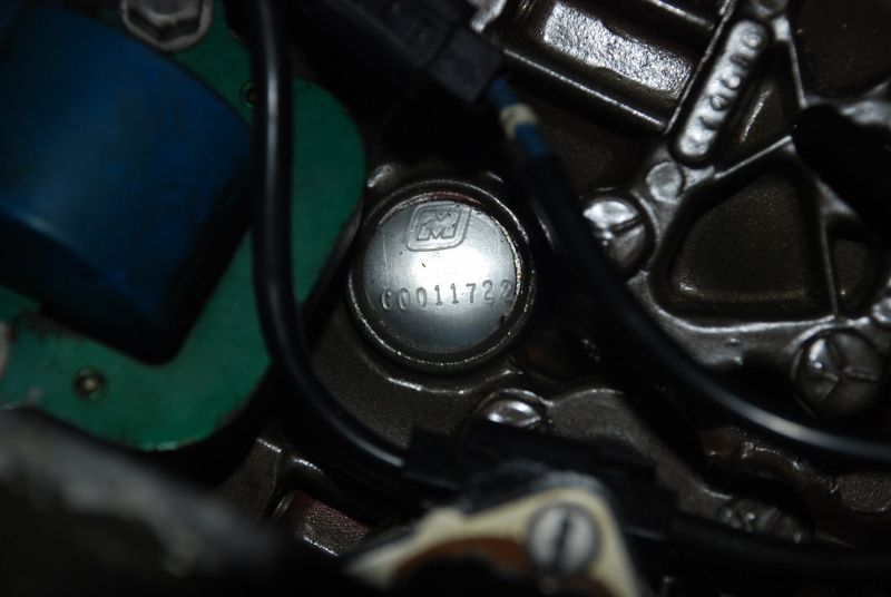

Thanks KirkSpock - the transom bracket is definitely a 1979 35 hp Evinrude Bracket. It's identifying the year of the rest of the motor that I'm having real trouble with (that's the picture of the nickle sized silver plate). Can anyone help with that?
boobie
Nov 5, 2009
20,826
Re: Can you Identify this Frankenmotor - Johnson Evinrude?
Call BRP customer service at 1-262-884-5993 with that core plug #. They may be able to help.

Thanks for the help everyone - so this was an interesting answer. I contacted BRP (the manufacturer of Evinrude and Johnson) - and they sent me a reply back quite quickly, indicating this was a 1976, based on the cowling. The problem was that the websites listing parts didn't list a 20hp as having been built in 1976. I contacted them back, and they indicated that the 20hp Johnson I had was built in Canada for the Non-U.S. market - and sent me the parts book I needed.
Talk about great customer service - still providing information on a product they made 37 years ago!
