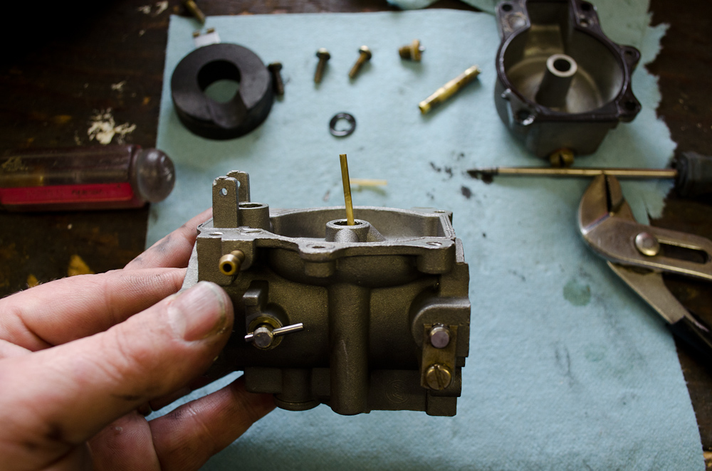

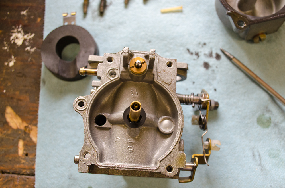

So I took the carbs and leaf plates off. Found a couple of interesting things that might explain my problems.
First - a question on the carbs - is this normal. That is - is it normal for the centre nozzle/tube to be offset to one side as the pics below show?

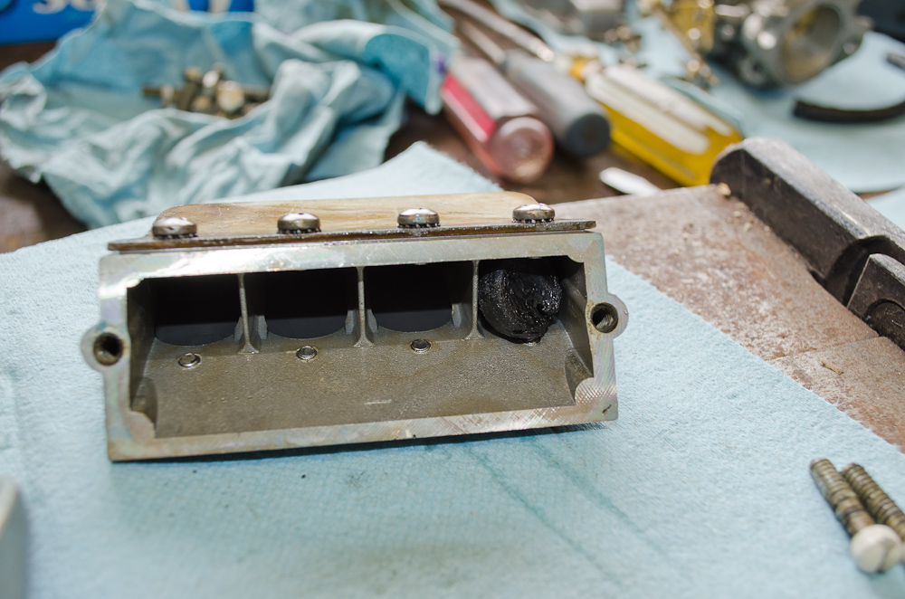

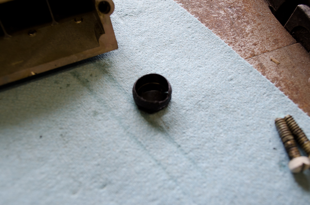

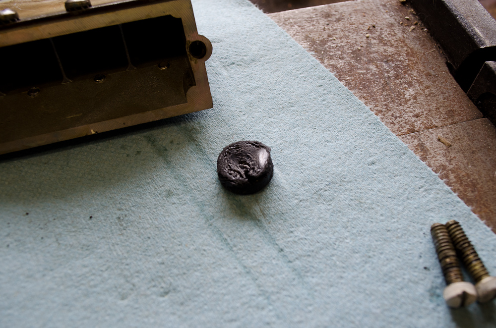

Now, on to the more interesting bit.

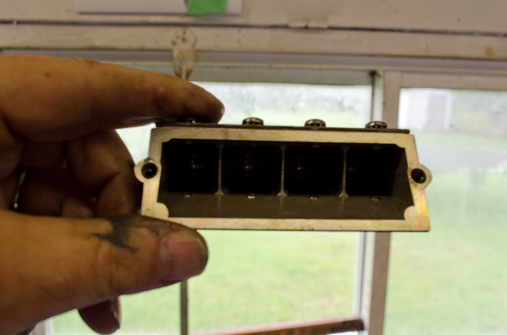

When I took the leaf-plate assemblies off I discoverd some kind of black plastic cap lodged in one of them. It looks pretty chewed up. I have no idea how it could have gotten in there or how long it might have been in there, but I'm thinking that, at the very least this cannot be helping?

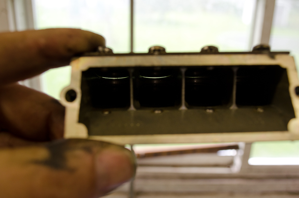

Then I held them each up to the light. One looked like this, which seems ok to me:
But one has 3 leafs on one side that do not close completely. I'm thinking this won't help the engine idle well, and may also explain the excessive oil back through the carbs and into the air silencer and from their leaking into the engine case and water?
Questions:
1) Would it help to take this leaf set out, flip it around, and install the other way? Or is it just worn and needs to be replaced?
2) I cannot seem to find the leafs themselves available anywhere online, and most places list the whole assembly as unavailable / obsolete. I did find one place that might have the whole assembly in stock. Should I go ahead and order two and replace both whole assemblies for good measure, or is it not like brakes and u-joints and such and it's ok to just replace the one? They run about $100 each!

Well, I figured a leaf-flip is probably not a good long-term solution, but I wanted to know if I'd hit on anything so I flipped the leaf, cleaned the carbs, removed the little plastic plug, and buttoned everything up.
Didn't change a darn thing - still stumbles/misses at idle like in the video and still won't start if it quits before it's warm.
