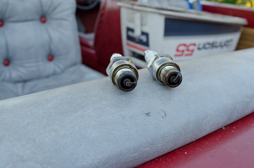

Spark seems good, have changed plugs 3 times, plus always seem a bit oil fouled. Also seems to me to be excessive oil at the spark plug hole but then again, I have little experience with OBs so no real frame of reference.

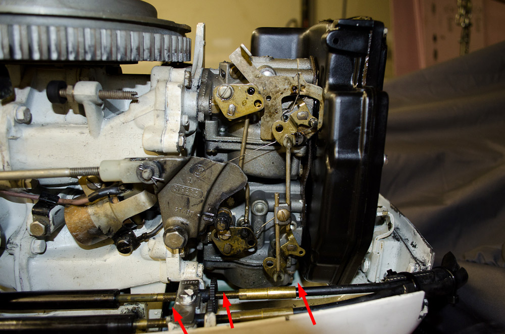

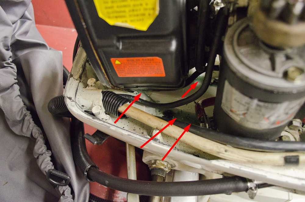

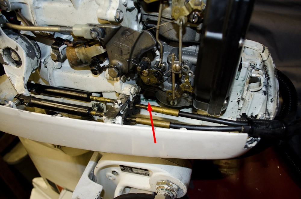

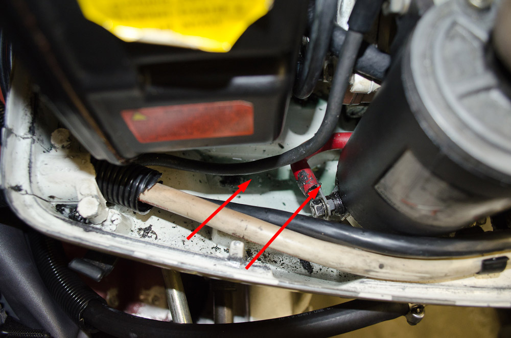

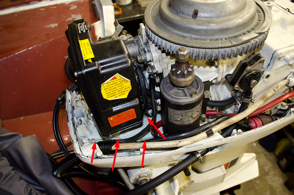

Here are some pics of the oil in the housing:
As seen from port side:
As seen from stbd side:

1. it sounds like you are on the right track with overhauling the carbs.
2. There should be a small hose on the bottom of the air silencer that runs to the block, is it attached to the block?

It appears as though the oil is running out of the air silencer. As mentioned above, there should be a scavenge tube from the bottom of the airbox to the block. It's basically there to get rid of any excess oil in the airbox and send it into the block (it's really not a big deal if it fails to do its job). 2-strokes don't have any pressurized oil passages, so blow-by doesn't really happen. Carb rebuild and link&sync are two very good things to do straight out of the gate. Carbs are fuel delivery as well as lubrication delivery, and they've gotta be working correctly or you'll have a very short-lived boating experience.
Clean out the scavenge tube (and check the airbox outer gasket) if you're worried about the oil. Otherwise, you can just follow the sheen back to the dock at the end of the day.

Yes, the small hose was attached between the air silencer (thanks for teaching me the right term!) and the block. However, it's a little old and the fit to the plastic nipple on the air silencer didn't seem very tight (the end of the hose is belled out).
Are you guys saying the scavenge is FROM the air silencer TO the block? Here I was thinking it was from the block to the air silencer (i.e. to scavenge crankcase vapours from the block back into the air silencer and then into the carbs for combustion!
Question: How does the oil get into the air silencer in the first place?

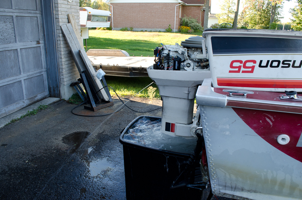

'Nuther question - and this might just be one of those darn coincidence things. I was trying to run the motor to warm it up to do a compression check, and I tried the muffs and then with the lower end in a large bucket (a big old cooler, actually). But I didn't get any stream from the tell-tale. I put the muffs on over the inlet holes (I think!) - the holes indicated by the red arrow in thie following pic. And in the cooler-bucket - the water level was up to the red line:
Am I doing something wrong or has the water pump chosen an inoppertune time to go south?
The line from the block to the tell-tale outlet seems secure and no water pooled in the powerhead housing.
Oh - I have to fix the excess oil leak because the boat's dock is also my wife's fave fishing spot and she hates when gas or oil gets in the water:

Take a weed-whacker line and chase it up the tell-tale hole. It may just be a clogged line.
The scavenge line actually goes from the silencer into the intake manifold. There's always a little blow-back through the carbs before the reeds close up all the way. That puts a little fuel into the air silencer. Fuel has oil .... I think you get the picture. Unlike a 4-stroke, fuel & oil mix travels throughout the ENTIRE (pressurized) crank case. Once air& fuel get past the intake reeds, the only way out is through the exhaust ports.

Pulled the tell-tale hose off - it's clear from the elbow at the block to the outlet orifice. Still no stream though :grumpy:

Yeah, that's not good. Sounds like a water pump went out on you. If you're going to run it in a bucket, the water level needs to be a few inches over the upper fin.

Just to add, from experience: When using ear muffs on 2 stroke out board, the vibration and jerking of a cold motor when starting can mis-place those ear muffs, essentially smoking the impeller. Either use a tub, duct tape the crap outta it, or have the wife hold 'em on good.

Tomorrow I will try and find a deeper bucket and if there's still nothing I guess I'll pull it apart and have a look at the water pump / impeller.

Well, the good news is, there's nothing wrong with the water pump / impeller. Turns out a deeper bucket was needed. Has good strong flow now.

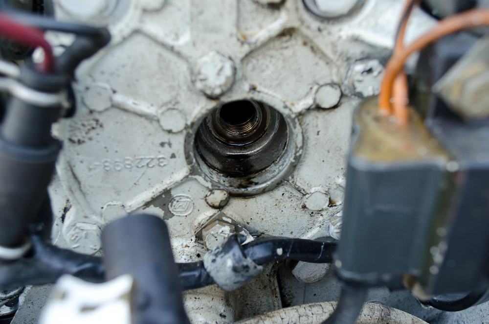

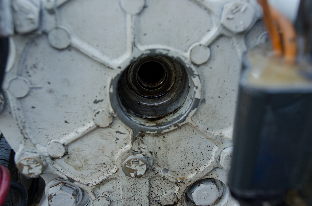

The not so good news:
plugs (only a few hours on them):
upper cylinder plug hole:
lower cylinder plug hole:

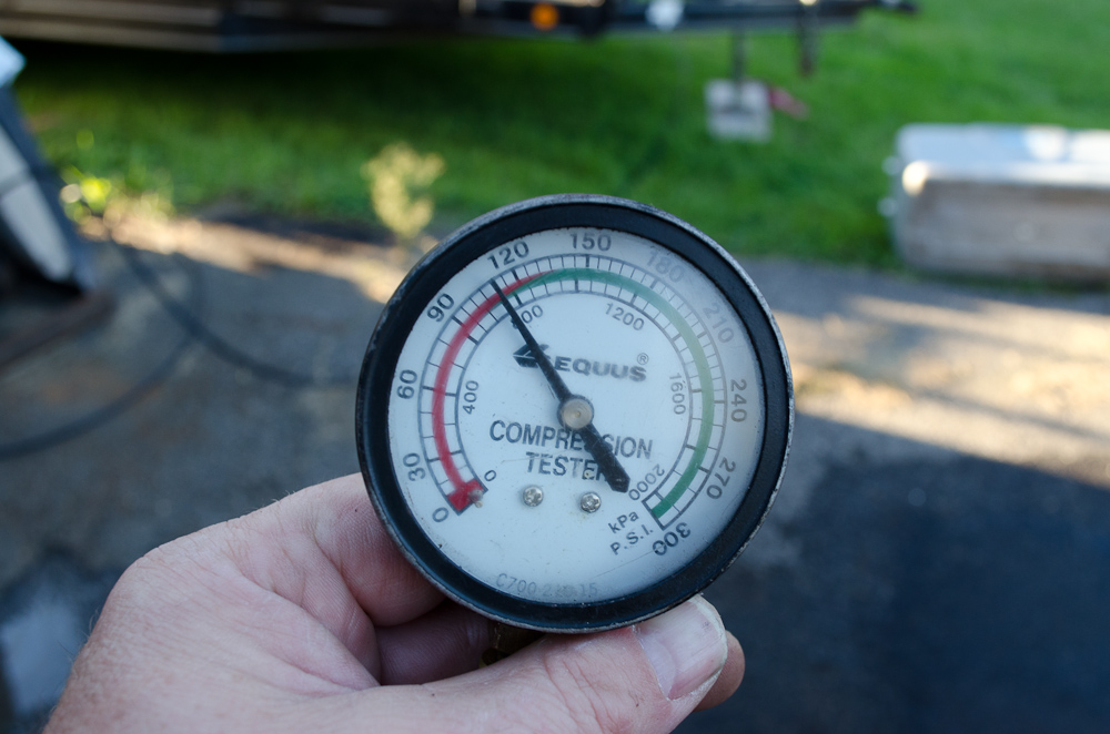

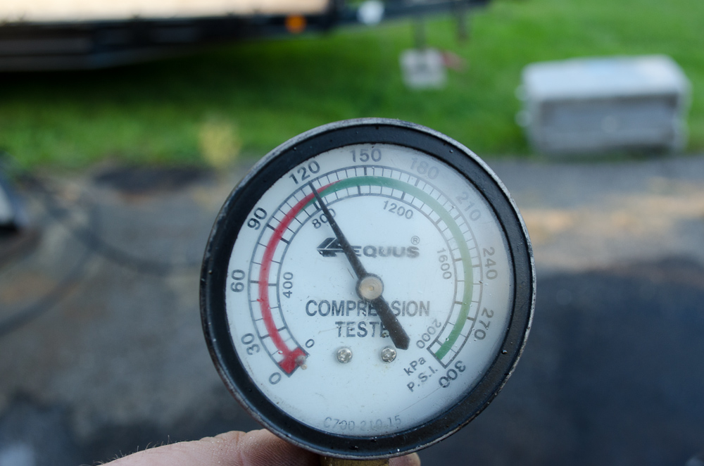

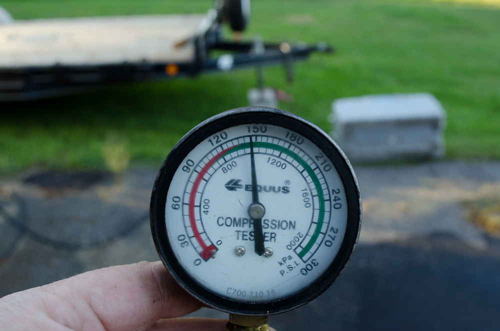

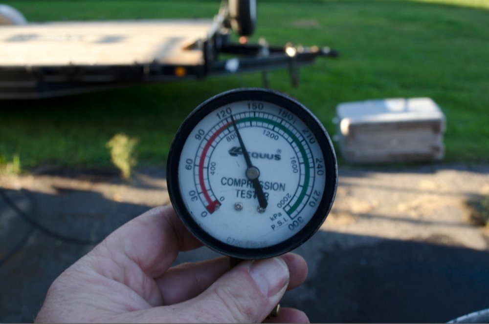

upper cylinder compression
upper cylinder compression after couple oil squirts
lower cylinder compression
lower cylinder compression after couple oil squirts
BillaVista
Jul 1, 2013
204
Re: Can you offer some places to start with my 79 Johnson 55 problems?
Questions:
1) Could this be the cause of my poor idle (stumbles and drops a few hundred rpm), stalling when going into gear, and hard to start if not dead cold or thoroughly warm?
2) Is there any point doing a carb rebuild / link and sync before correcting this?
3) What are the chances it's just the rings that need replacing (and not a piston replacement and cylinder bore required)?
Daviet
Sep 24, 2008
8,958
I would start with a good decarb, if that doesn't improve the numbers, pull the head and take a look at the cylinders for scoring.
