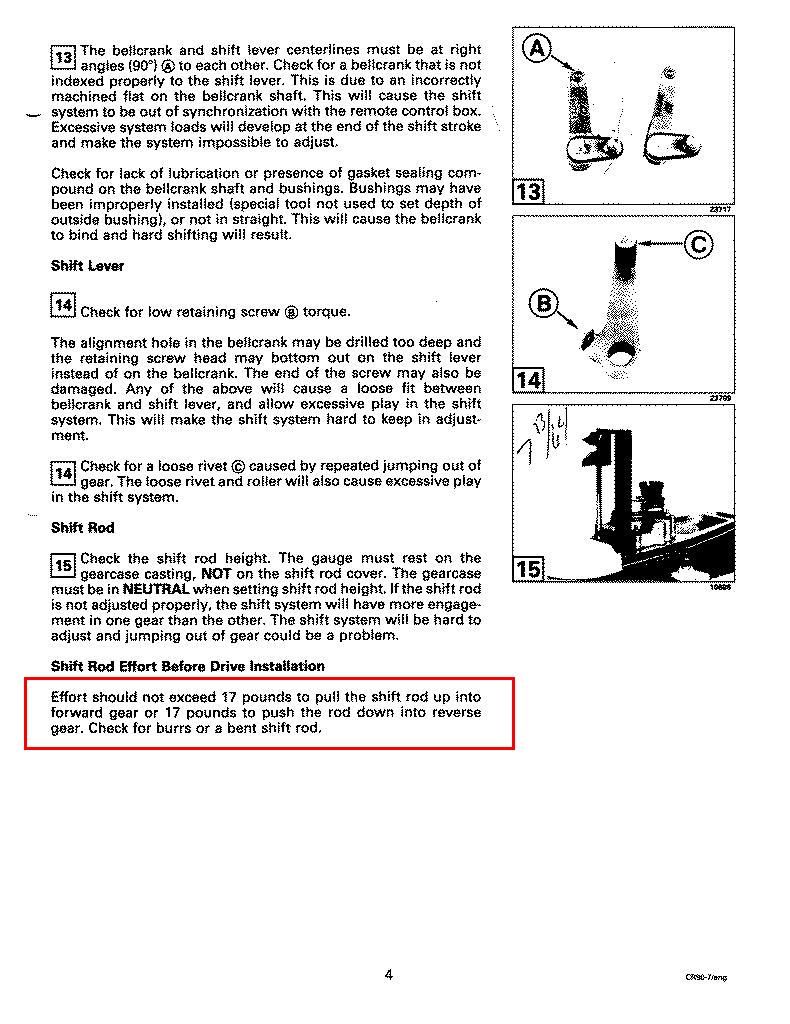

Also Found this (pic below) it reads 17 pounds to move up or down. After it sits about 30 mins, I think I exceed that to move it. After that its more like 3 or 4 pounds to move it.

Re: Changed my shift cable, here is what I did. NOTE ** NEWBIE **
What do you think would cause the out drive trim to only click on the pump and not run?
Failing solenoid.
Very strange that the effort required to move the shift rod changes over time. Almost sounds like a bad seal.
