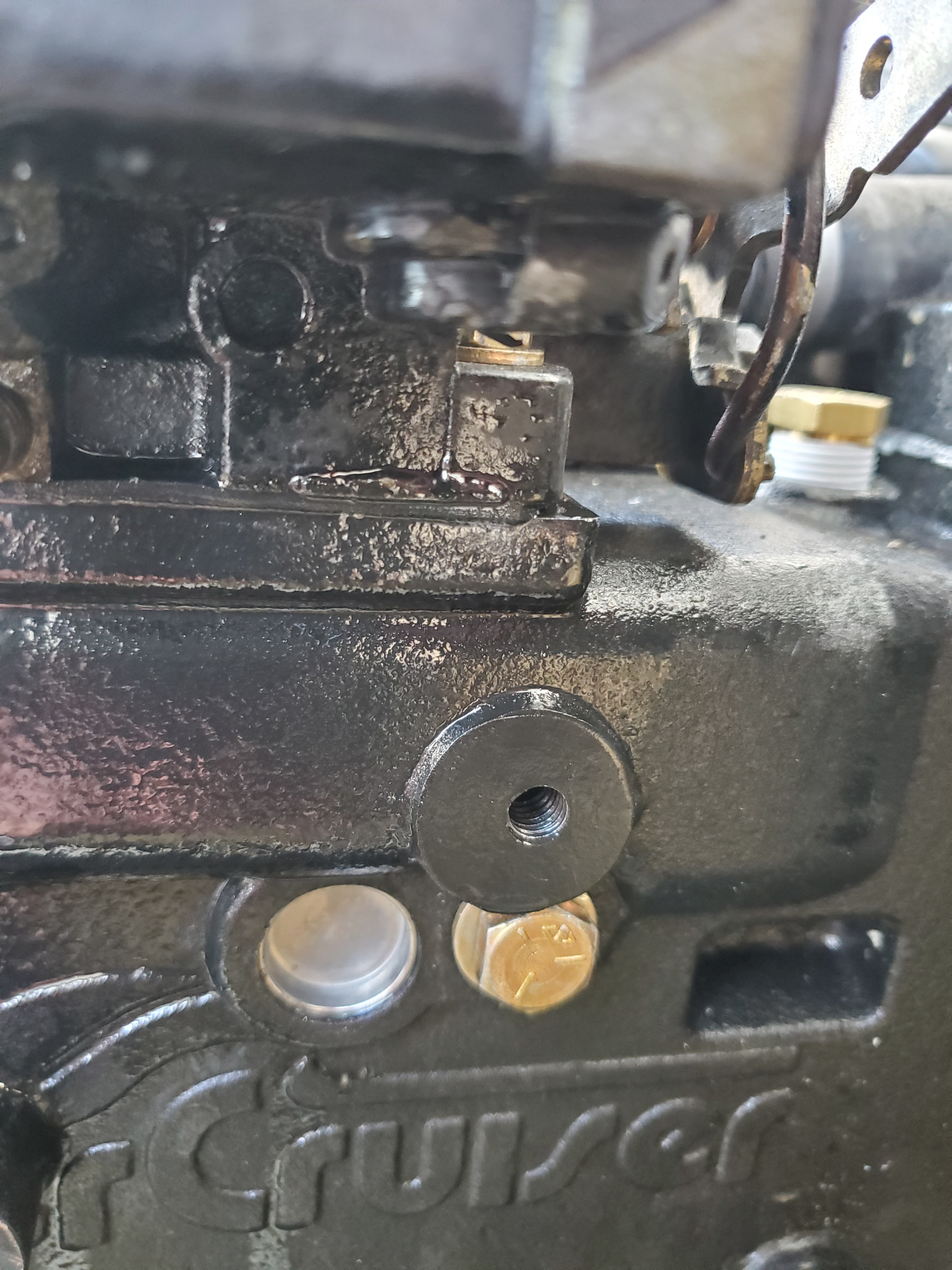

Another caveat when changing this manifold on a 3.0. On the side of the manifold close to the stud on the carb base there is a drilled and tapped hole that leads into under the carb intake runner, if it's left unplugged, it's a vacuum leak. It causes a uncontrollable idle and dieseling when shutting off. I have a picture but my inability to post pictures here continues to flummox me.

No one can currently post pictures so don’t take it personally. I think that hole maybe for pet of the throttle linkage on older models it sure it should go through to intake passage. Is this an oem or aftermarket manifold ?

The replacement I had also had a hole there. Seems it is built to work for both applications. Sealant and an appropriate sized bolt fixed that problem for the 11 years I ran it.

Mercury made it for this application so it's OEM, the manifold I removed had no hole there. https://powerboatsupply.com/uncateg...-mercury-exhaust-manifold-assembly-860235a04/
It fixed mine as well, I only posted about it so others would know and not find it accidentally like I did
