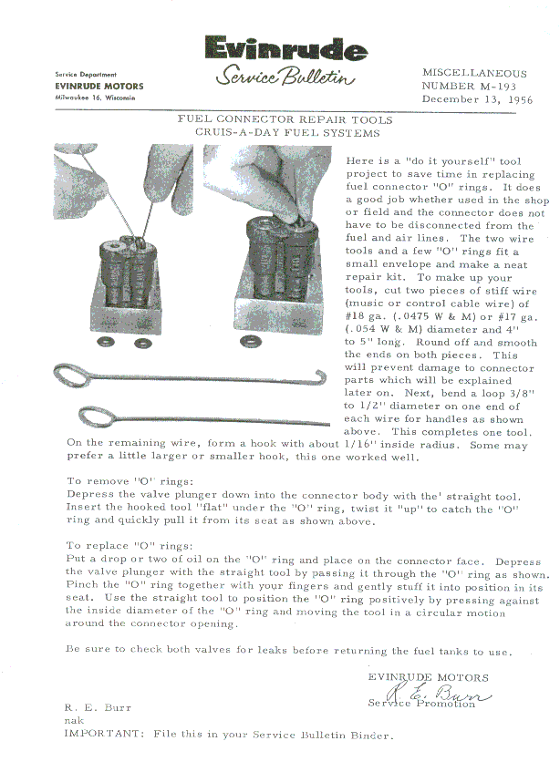

yup gotcha I found an answer to the question in the mean time... check this webpage out, it's got a bit of info. on the pressure tanks but the coolest part is it has photocopied news posts from evinrude about fixing the tanks and fittings .. http://www.duckworksmagazine.com/02/columns/max/02/wawrzyniak.htm
bottom left column

Use a couple picks. I use a stainless steel dental pick and a small screw driver style hook. You could substitute a paper clip for the dental pick. I use the dental pick to push the rod down and then pick out the o-ring with the hook. I've pulled out o-rings as hard as rocks using this method. Usually only takes a minute.
