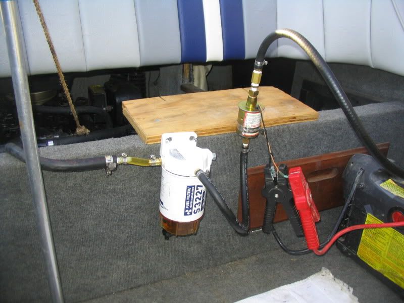

... maybe put in a gal and pull the boat around to it will slosh. Pump it out with electric fuel pump then repeat...
Place a Filter In Line with the fuel pump and pump it right back into the tank.
After about 5 times around the circuit, you will gave filtered over 99% of the gas.
Example: If the fuel pump moves 30 gallons per hour and the tank has 5 gallons of fuel in it,
after an hour the 5 gallons will have been filtered the equivalent of 6 times. (99.75%)
That's exactly how I cleaned up the 80 gallon tank on a Wellcraft. Worked like a champ!

Ayuh,.... 'ell of a Solvent,...
I built 1 of them fuel polishin' systems with an ole electric fuel pump, a Mack 2ndary fuel filter, 'n some fuel line,...
Works Great,....

And, be kind to the little fuel pump.
Be sure to place the filter BEFORE it!
