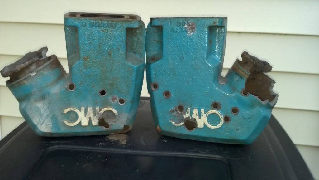

Cracked starboard exhaust manifold ('79 OMC 260)(PICS)

I was thinking along those lines as well regarding the exhaust studs. I can still get a hold of them at about $20/each.
Ill have to do some more research about the rear main seal details of the engine I have. I did a little looking around for rebuilt blocks online and did find that there were options out there that needed info on what seal arrangement I had in order to purchase the correct block so I understand what your saying.
I started looking into what it would take to physically pull the motor when I get around to it. Looks like I can pick up a simple chain hoist( http://www.harborfreight.com/2-ton-chain-hoist-631.html ) and either hook that up to a large tree branch or build a simple gantry. Sounds easy enough.
Newer sounds more expensive to me! :) Plus, Im pretty sure Im limited with how much more power I can run to the OMC 800 Stringer. I dont know that I would get any benefit from running a more powerful motor.
Oh, and I found a good use for the old risers....
