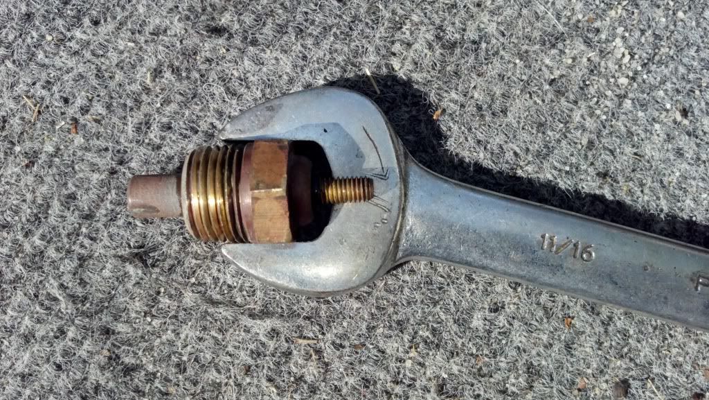

Also, going back to my temperature issue. Ran the boat on the muffs again and the gauge shoots up to 180F after a few minutes. External temperature, measured with infra-red thermometer at the sending unit never gets above 153F at idle and hovers right around 160F when I rev her up a little. I grounded out the wire from the sending unit and it pegs the gauge so if what I have read around the net is correct that means the sending unit is bad.
Here is a picture of it:
The OMC part number 171690 and from what I can tell, the correct Sierra part is TS26621 3/8". See the link: http://www.iboats.com/Engine-Temper...3515160--session_id.469191005--view_id.392180
That's it for now. Wish me luck on the lake tomorrow!
Not quite correct. Grounding the sending unit just pegs the gage and tells you that the gage is good.
Go invest in an inexpensive multi-meter from Radio Shack or Harbor Freight etc...
The resistance values for many senders are in the following PDF.
faria-instruments.com/site_manuals/IS0085E.pdf
