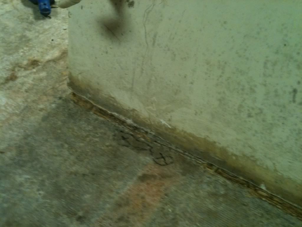

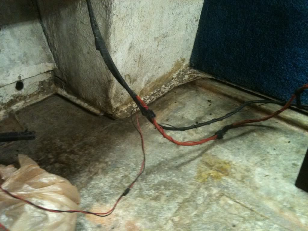

After a little more reading regarding the balsa core construction as suggested above I believe that's what it used to have. I tried to replace this deck in the late 90's with 2 layers of 1/4" AC overlaid with poly resin. I did not encase the 1/4" just tried to seal it using resin but no cloth. I must have missed a leak somewhere because once it came into contact with water it delaminated after 3 years. So the pics attached are what I have now - bare glass hull. I read a lot last night and even watched some good vids on youtube on stringer replacement. I am thinking about adding glass to give the hull some added thickness, (4) dimensional lumber stringers bedded to the hull and encased, poured foam in between, and a 3/4" treated plywood deck on top. This is a fishing boat and looks are not nearly as important to me as safety, function and ultimate cost.
Some may suggest 3/4" encased plywood for the deck, but I am a bit leary of that notion since I have already tried 2 layers of bonded 1/4" and it failed. Not sure if stringers would have prevented that failure or not. Any input is greatly appreciated - don't want to do this a 3rd time lol.

the reason that the deck most likely rotted was because the foam was saturated.
you say you have the boat down to the bare hull?....
please post pics of the structure.
cheers

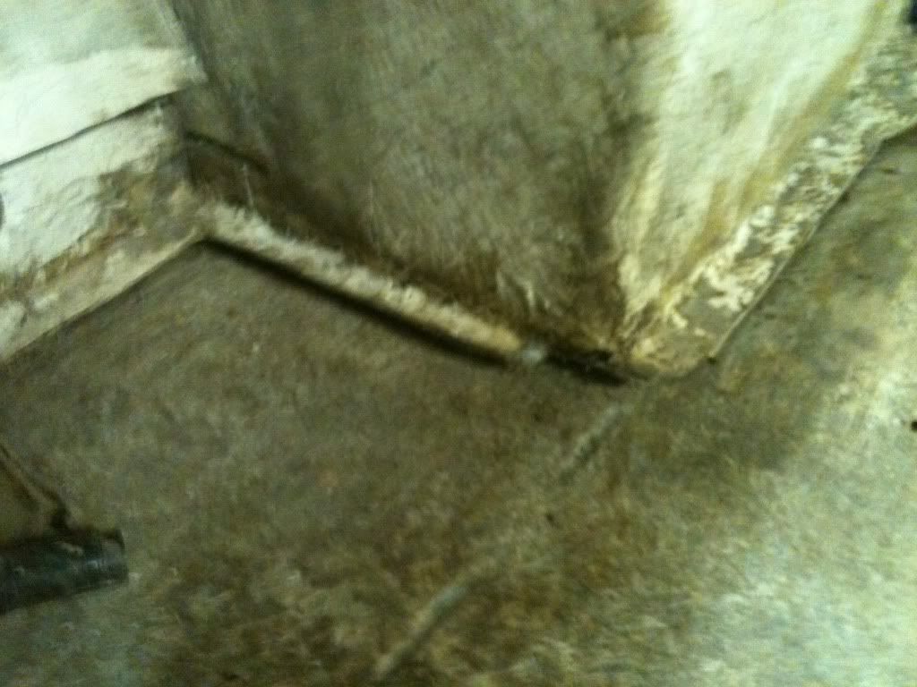

Re: Deck Rot but boat has NO STRINGERS? I searched!
Hopefully these pics can be seen better. Any input is greatly appreciated?
Now your cooking w/ gas. This 1's a great shot. Even cell pix can be pretty good. You might try to re-shoot those 1st 2pix you just posted, they lose a lot of detail in the blur.
Hopefully, you'll get some experienced glass gurus thru here now that they have some details
hard to tell from the photos, is the the bottom of the hull, or is that simply the underside of the sole?
Scott,
Thanks for replying! That first pic is the actual bottom of the hull near the transom. It was a balsa core hull from the factory. The balsa turned to mulch. I'd rather not put rot prone balsa back in, hence my inquiry about Divinycell. Would the same construction principal work though? ie, glass-Divinycell-glass?
