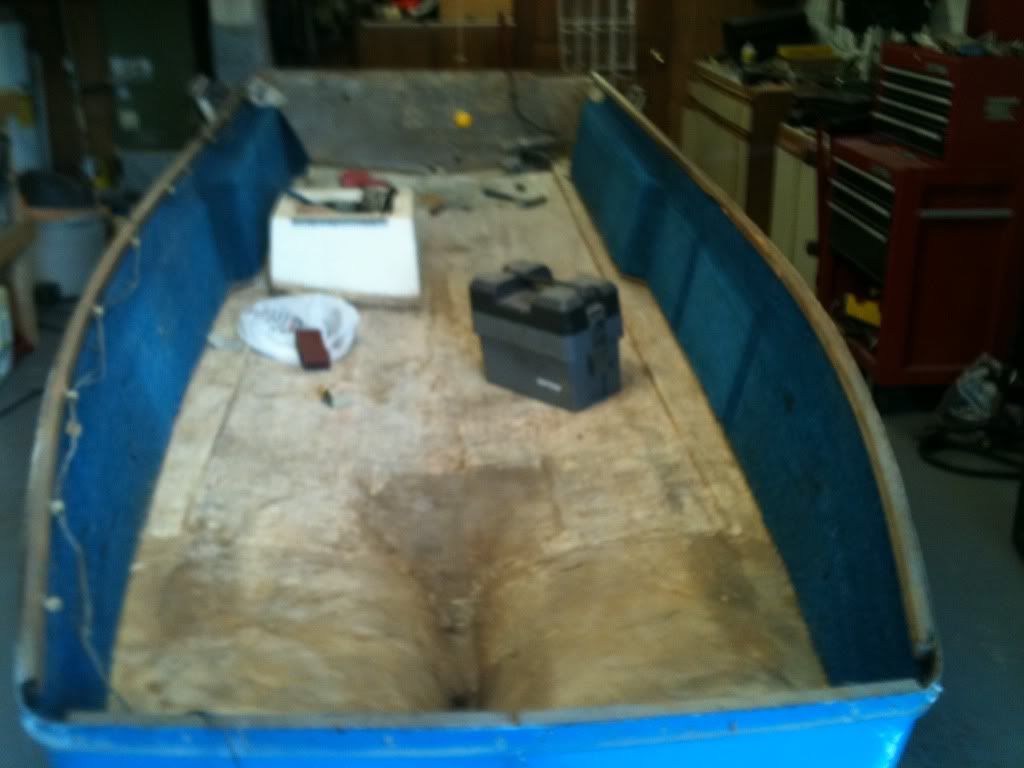

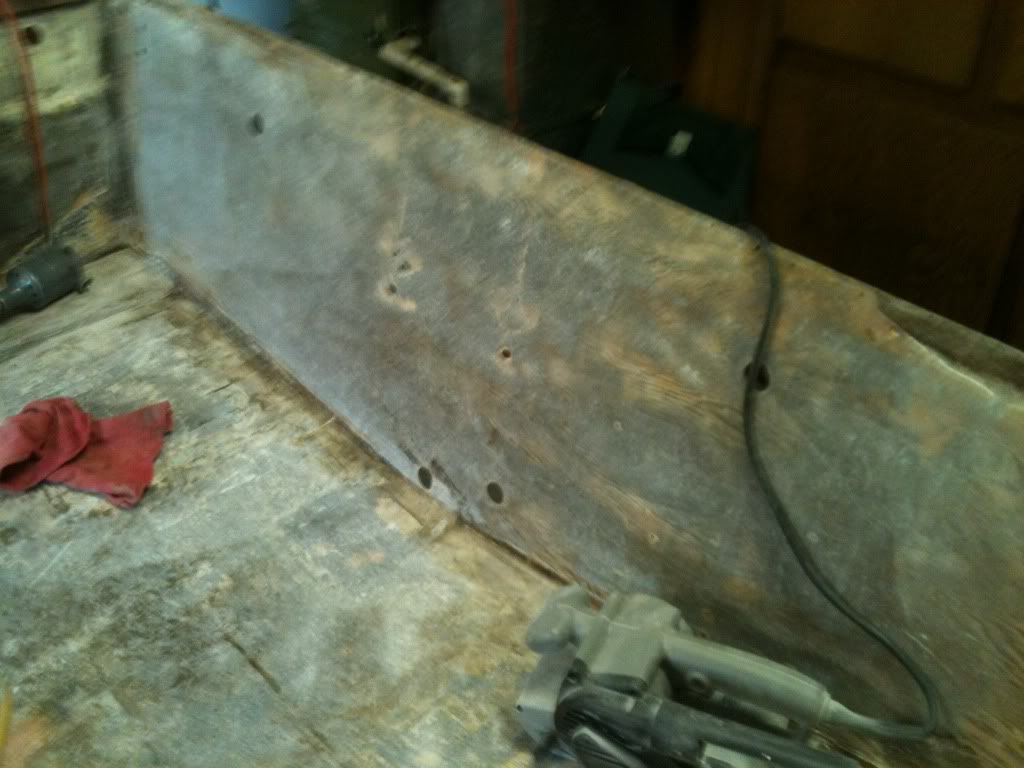

Re: Deck Rot but boat has NO STRINGERS? I searched!
These are pics of the hull and transom area. It is down to outer skin.
Im sorry .. but I dont know what else to say.
If your not going to recore with balsa .. then your going to attempt to recore with ply.
Like I suggested with the ply route is that it May not work.
What are you planning on doing at this point as far as core materials ?
How thick is the glass on the hull ?
YD.
The outer skin is scary thin, that's why I wanted to add some thickness with CSm before I try to core with anything. The balsa is just too expensive for a core though, and I can get 1/4" Greenwood XL plywood locally and save shipping so I have decided on plywood core. I realize poly is not a good adhesive and delamination is a real danger. That being the case, I am contemplating adding 2 stringers to reduce hull flex and fitting a layer of well sealed 1/4" marine ply between them. My big question now is what to bond the ply to the hull with to avoid high spots and get good contact.
