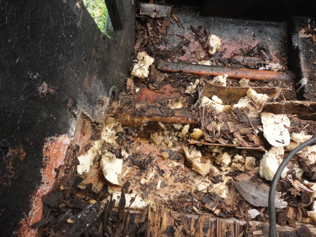

I found a tone of wet soaked foam towards the transom.
Question.. I have also noticed that the deck was not tied into the hull. Is this normal?
When I am ready to reinstall the stringers, would it be an ok idea to wrap the stringers in glass before glassing to the hull?

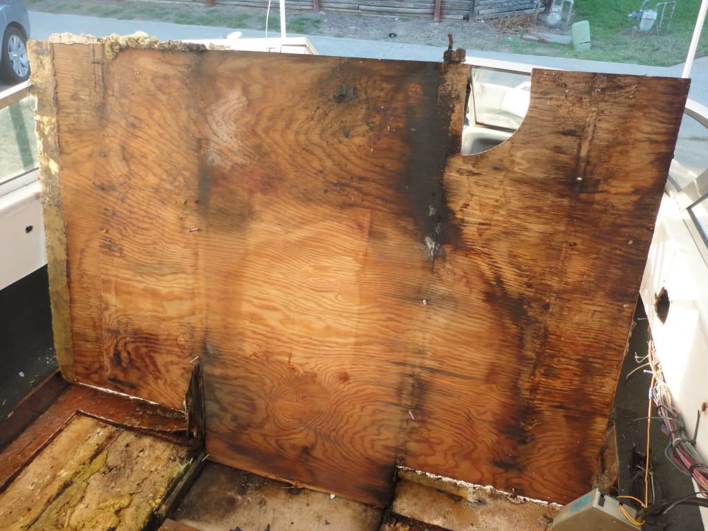

I'm pretty sure this is not normal, and I suspect someone else has taken a crack at that deck in the past and didn't really know what they were doing.

Yep someone tried fixing the deck at some point. They did a total bad job at it. instead of glassing the top the put a skim coat of epoxy and then put carpet over it. once I pulled the carpet totally up I could see it. the used caulking to seal the seams. I was able to pull up the entire sheet of plywood they used and they even tried screwing the deck down.. The current stringers have NO glass on them what so ever!

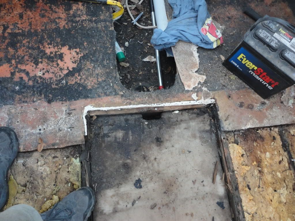

Made some prgress today. still lots of water in the soaked in the foam. As you can see I was able to remove my gas tank. Had to empty 12 gallons of gas first and burnt out 2 pumps doing. Anyways..
Question.. When I pulled up the tank, there was a piece of the gray carpeting which lines my boat under the tank. Is this normal to have something under the tank and ontop of the hull?
Question #2... There is what looks like a drain hole under the tank, in the hull, maybe in the center of the boat, as well as in the ski locker; isn't this supposed to drain into the bielge area?

Your fuel tank should be sitting on plastic strips so any water can escape and air can circulate around the tank especially if it's aluminum.
There should be drains from the locker and fuel tank area that go to the bilge.
