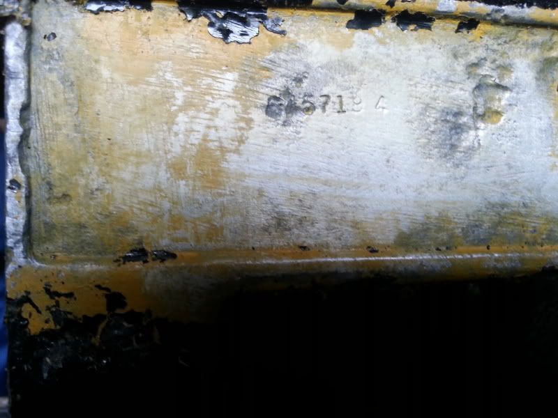

Oh bother!! No good I'm afraid. The body there has taken a scrape at some point. I get maybe 5 numbers and guesswork on blurs

The numbers appear to be 645719 4 however that number does not reference against a range in the tables in the sticky
