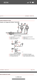

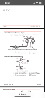

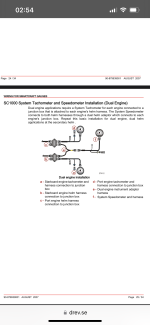

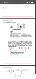

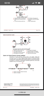

Hi. Can I suggest that if you are referring to the sc100 gauges, meaning the smaller gauges for like fuel and trim etc (that are nice to have but already shown on the sc1000’s)…I am happy to inform you that you don’t plug these into the junction box (if that’s what you are asking). They are plugged in, in line with the sc1000 gauge harness dedicated socket (weather capped off when not in use). You can run a couple of them in series this way. I’m sure I’ve a picture of my set up somewhere.

This might help. If you don’t already have it
