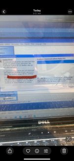

I orderd a diagnostic cable and software, got it installed on a laptop. But the cable doesn’t match this, which is where the cable is supposed to connect, I think?

setting up the comm port is a bit tricky... my last W11 install of EV diag 5.9 was a challenge and I had to go into settings * and disable a security control to allow the silly thing to work.

EV works with special FTDI drivers that allow a USB port to talk to the EMM with the special cable. you must have those drivers installed on your computer
this needda lot of fidling so if you are not at ease with SW loads and drivers maybe a friend can help out.. patience brings joy!!

I appreciate the help, I really do. I’m not computer savvy, at all. However I did install the software onto the laptop without help. After no communication notices, I installed the 5.9 update, and believe me, I’m very surprised. My point is, reading that all that stuff, it may as well be written in Chinese. It goes way over my head

There is a learning curve but I don't understand the cord issue. Did you get that resolved? Should only be one, triangle shaped. And yes, on the side of the emm are 4 led which gives you some diagnostics. Are they turning off?

the trick is to have the needed drivers for the usb port and EV will see them assigned on a COM port .

I had to go to control panel, device drivers, click on advanced and I had to enable that com. Can't remember the name but it was the top thing in the advance menu.

This might help....Enumerator was the joy for me.

My mother in laws BF was here a month or so ago and he’s a whiz on computers. He installed windows 10 on the laptop that I’m using. He helped me go through a couple things, I tried them, but I haven’t followed up with him yet. But I’m thinking that there’s probably an issue in the BIOS??? settings.
And I don’t see any lights on the EMM
