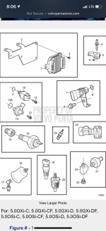

Sorry bout all the questions… but confused on which is the proper sensor. Am I looking at 19 or 20. I think 19 is on the tstat housing and 20 is on the exhaust manifolds - one on each side.8703264F-C9EF-4221-8DEB-2E058FCF861D.png
alldodge
Mar 8, 2009
44,792
It should be 19 because the ECM sensors use a ground wire, where temp gauge sensors use the body as ground

Alldodge… replaced the ECM and MAP today and seems to have done the trick. Hooked the Rinda up and temp at startup was high 80’s and idle was better. Real test will be the next time I start cold and hopefully it’ll start up on the first try without stalling. Thanks again
