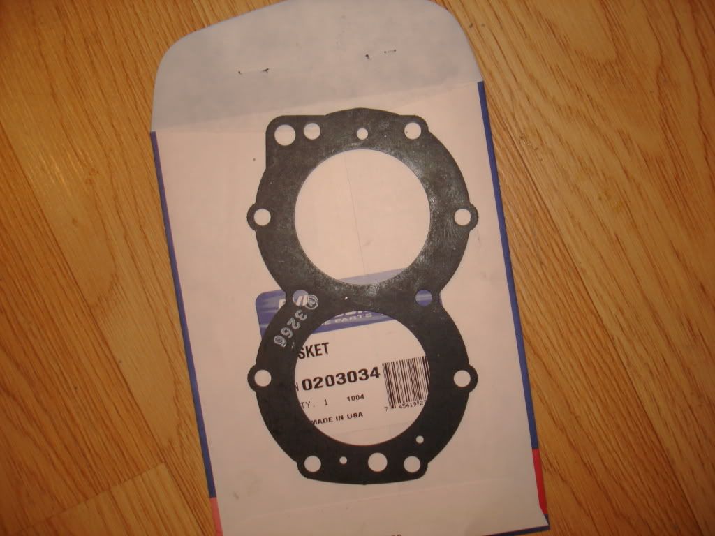

Metal head gasket? What part number did you order? There are metal inserts around the cylinders if that is what you are referring to. Do you have a pic?

i too would love to see a pic of this new style metal headgasket....and the brp part #.

I'm eager to see it as well. Although I'm always willing to learn something new, I can't see BRP making "new" head gaskets for the '57 7.5's.

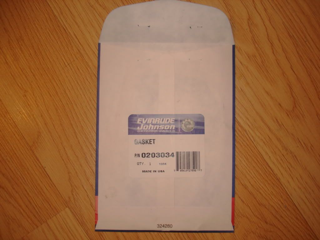

Picture of the new head gasketbfrom evinrude brp .

That's certainly the right part number.
I guess there's something to be said for a completely different parent company that's 4+ decades ahead of having nothing to do with producing that engine, yet they still carry new parts for it. Kudos to BRP.

Notice on the package the almost forgotten phrase "MADE IN USA".........
It's been a while since I've seen that one. I'm a BRP fan....
I'm still in shock that it's all steel. I expected the steel inserts, but don't see how the all steel would work properly.
MLS gaskets have worked fine on millions of car engines as intake, exhaust, and yes even head gaskets. Guess we will see how it works for the OP.

I copied that picture, changed the brightness, contrast, etc and see a faint glimmer of what looks like the normal steel ring that would sit upon the top sealing surface of the cylinder sleeve.
Duck..... Are you actually saying that the entirety of that gasket is made of steel such as various automotive gaskets OR is the majority of that gasket a fiber material of sorts?

No The gasket ,The new one Im talkingabout is made of metal . The old gasket is a fiber gasket type of material .Thats The replacment one i got from evinrude BRP . So My sealing surface must me flat for the metal type right . I never seen a gasket for a head made of metal , On lawnmowers and I heard of some on older cars , but not on outboard motors . I gave them the part number and I got this gasket for my engine . It must work for some reason , I dont know if I'll have any problems with it . How can I tell when the engine locks up , Just wondering .

Strange, I cant count the number of 50s OMCS head gaskets that I have done, never once seen an all metal gasket. I order them all from BRP.

very odd.....cant see how that would seal using the relatively low torque specs for the head bolts....( or screws). has anyone seen an all metal head gasket on any ob, of any era? ohh..wait....i just had a glance at a british seagull that i got in a box.....and it does have an all metal head gasket....soft copper!!

Well thats the right gasket For the motor . I looked on marineengine.com and it looks the same in the picture . The old gasket is a aftermarket gasket not the one from evinrude . So I guess it should work out . Thats why I was wondering if the gasket needed a sealer coumpound on it like omc gasket sealer . I cant see it sealing water to well , but if thats the gasket they used when it was new it should be ok . I have to touque it to spec's maybe a little tighter 1/4 turn .

definitely not the gasket used from new, and 1/4 turn past the recommended torque spec could easily double the torque on the head bolts...not a good idea. jmo
That was my thoughts as well. It's not like I've never seen an all metal gasket, just not on an outboard. I would think the head and
block would have to be flawless. Honestly, I'd have to call BRP back and double check it. I wouldn't trust it.
