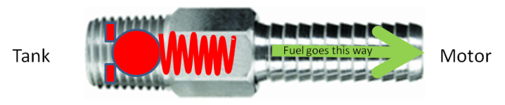

It looks like a barbed fitting but has a spring a ball inside it
