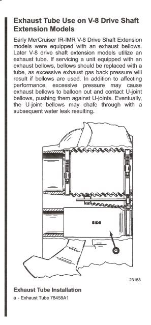

I was reading up on bellows replacement and ran across an article on
page 4b-6 of the mercruiser service manual #6.
exhaust tube VS exhaust belows, they made mention of the IMR drive, and we just have the MR drive.
But what caught my eye was that it mention excessive back preasure and a "loss of performance" if you use the older bellows instead of the new exhaust tube.
Should we just do away with the bellows contacting the drive????

I am just a little curious after reading the paragraph on page 4b-6 in the #6 merc manual.
expanding bellows???
loss of performance???

Do you have a drive-shaft extension on your boat? They're not too common on anything I'm familiar with.
If you don't have a drive shaft extension, don't worry about it. If you do, use a tube.

guys-
My point is/was that I just have a MR drive, and if there is an issue of lost "power" by using a exhaust bellows instead of the tube.
The old tub needs all the help it can get!!! :)
