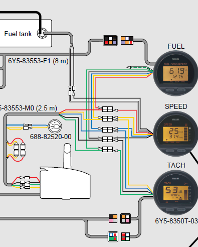

Have you any idea as to the model of the motor or the type of gauges that you have?
Might look something like this:

Blue is for the lights. Red is battery power. I would not think that you would want the lights to be on all of the time.
Lights are normally turned on by the key being turned on or by a separate light switch, as shown in the diagram.
boscoe99
Aug 22, 2013
2,319
Blue direct to yellow if no switch or blue to yellow through an on/off switch.
