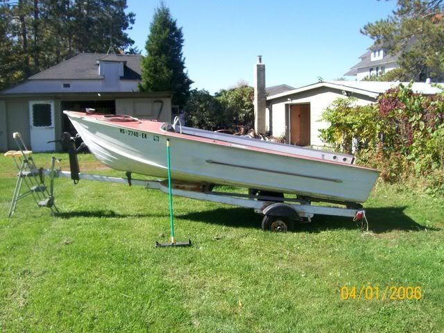

Finally an old tinny that I can work on with my daughter

I'd mount the engine first and look at whatcha got.
Those jack brackets are often used to a raise outboards,
seem to work out ok.
Converting over to a teleflex steering system might make life easier.
HAve you tested the transom core yet?
They only last so long.

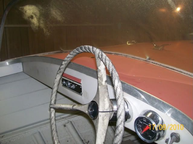

Although I ordered a new steering wheel I thought this one was kind of cool with the rope design.
I might decide to see if it will clean up and save it other wise its going on craigslist to see if any one else wants it.

Man with a little time, Patience, Epoxy, and Paint you could make that wheel look like a new one. AND it would be VERY unique!!!
If you decide to get rid of it send me a PM and I will deal with you for sure. I have a 62 Lonestar Flamingo that it would look great on.
I'm just sayin...:D

I would also be interested in that wheel to go in my 1960 Sea King, so if glass don't work out, send me a note!

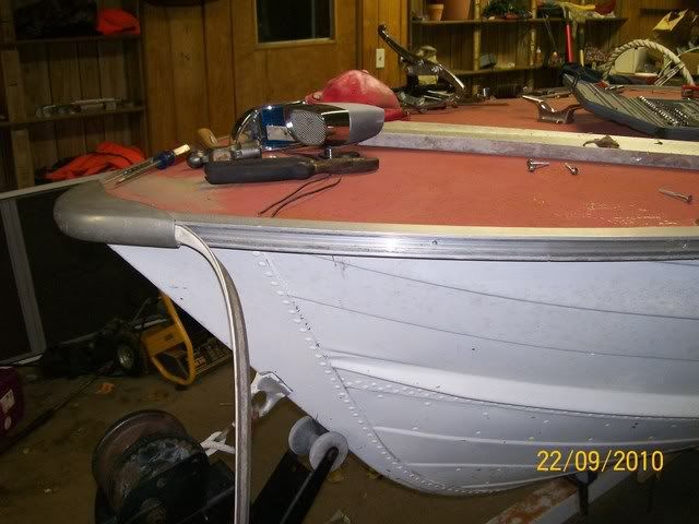

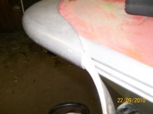

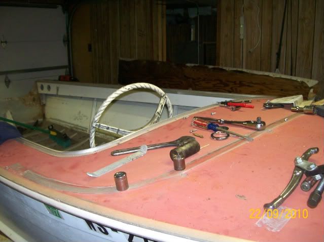

Ok eventfull night here. Wasp suck when ripping apart a boat. Found 5 wasp nest under varous parts of the boat as I was working. Hit one nest with a hammer and had to run fast. No wasp killing stuff available so I used starting fluid and carb cleaner. It worked! Went back to work and removed the windshield. I was trying to remove the dashboard and got all of the bolts and screws out but was unable to remove it. I think they must put the dash in first before the bow cover. So I decided that I wanted to remove the bow cover as well. Went to remove the bow cap and cant budge it. Finally figured out that you have to remove the rub rail first then the cap will come off. Unfortunatley all the screws had nuts on the back and since I cant be 2 places at once and my daughter is in bed I have to wait untill Friday night to get the bolts out to test my theory.
So for all you pic nuts I snapped a couple to help feed your habits.

If you take a picture of where you're at with the dash, I can probably tell you what you're missing in order to remove it. I replaced mine in my Jupiter with a PVC trim board from Lowes. It was real nice to work with and will never rot.

Thanks ezmobee I will try tonight to post some pics. I decided to remove the bow cover any way because I have an idea to mount a fuel tank on the braces under it. Reinell used to do it alot and so did many other boat manufacturers. I need to replace the wood braces with somthing meatier.

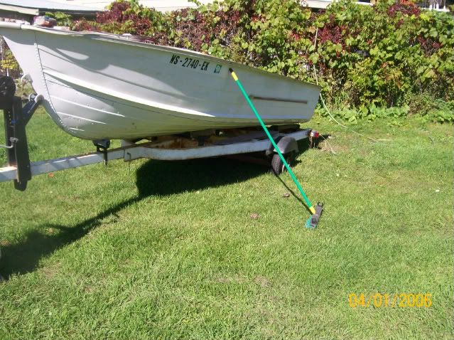

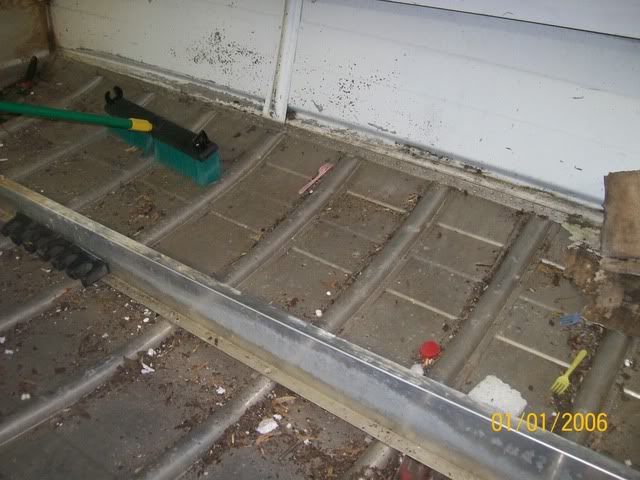

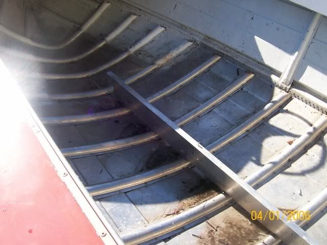

Finally got a nice day to get her outside to at least clean her out of old wasp nest and do a water leak check on the hull. Not a drop came out in 2 hours of sitting full of water. I will gluvit the inside just because I dont want to do it again.
A couple of questions first the bottomn under wher the floor was is not painted. I am wondering do I need to paint it? It looks really really good there and was never painted before.

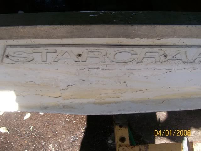

Is it ok with the starcraft powers that be if I sqap out the Seaking plates for the Starcraft donar plates? Please Please!

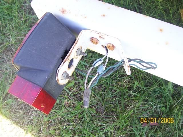

The pic below is my biggest pet peeve. Wire nuts are not for this application. and people wonder why there trailer lights dont work.
the donar plates from my starcraft
