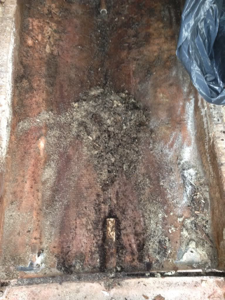

Ants not a good sign. I'm in the process of demo now and found a colony living in my foam along with a lot of moisture and rotten wood.

^^^ +1. In my case they ate the foam and the bulkheads which weren't encased in fiberglass
Was always wondering where all the sawdust was comin from lol

Don't be fooled with the solid feel of the deck, Previous Owners have a very bad habit of throwing new decking down over rotten stringers and saturated foam for a quick fix and sale... we've seen this dozens of times.
I'm guessing the bow deck made with treated wood isn't covered with fiberglass? This is another "quick fix", and a bad one that will let water get below deck.
Taking on water and ants being flushed up above deck means you have evil lurking below deck and/or in your transom and you need an exorcism (demo and restore).
Tri hulls aren't designed with bilge drains, they're designed with deck drains. This means the hull below the waterline has to be completely watertight with no hole or cracks to let water in... and the deck has to be completely watertight. The deck has to be completely glassed in and sealed with no penetrations or any penetrations well sealed. The 3 "V" shaped voids below your deck should be completely foam filled and nearly sterile with no way for anything to get in there.
My deck was nice and solid too. After finding a rotten transom I cut back some of the deck to check the stringers and they were completely saturated and rotten. The deck had been replaced over the bad stringers at some point.
