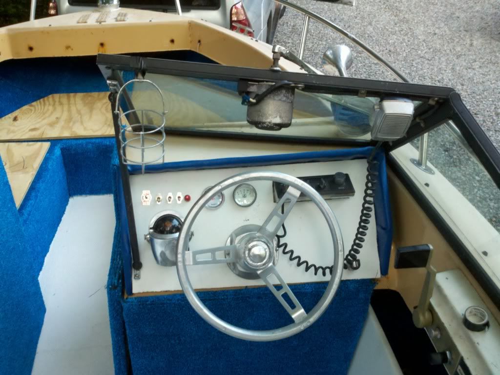

Using 12 gauge wire rated for 20 amps from battery to master switch (also rated 20 amps) to fuses (automotive fuse block). from fuse block I ran 14 gauge to my switches and 14 gauge wire to my horn, my depth finder, my front nav and rear nav. and to my radio. Then I ran ground from each device to battery.

According to the chart - 12V, the 12ga. wire at 75C (165 degrees F) in free air is rated 25A max.
The 14awg is rated 20 amps max.
I don't think that you have some hundred feet of wire, or running through engine rooms exceeding 165 degrees, and I don't think that you are running the wires in conduit. Protect those wires according to above. If you wish to limit current for whatever reason you may have (doesn't matter) you can do so.
In general, 20A is good all-purpose ciruit protection - it'll be fine. In commercial AC applications, 20A is the minimum circuit ampacity in a building (say a branch circuirt of wall outlets in a room), generally. In your house it is usually 15A - doesn't matter if your running your fridge, or charging your cell phone.

My experience, is that a radio will have an inline fuse in the power supply wires/connection that comes with the equipment.
